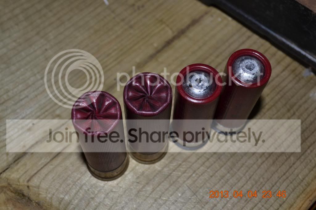

I assembled all this on my Lee Grabber Progressive, dropping the slugs into the wads and crimping the ends like a typical shot load. This is pretty fast and you can do hundreds in a session.
Then I added a drill press to my bench and started to make some roll crimped slugs.
You need to cut the hull down, I used a chunk of plastic water pipe cut to length as a jig. Simply insert the hull into the pipe and cut off the protruding end off.
You also need to cut the petals down on the wad to clear the crimp.
Once you get these assembled the roll crimper does a great job. All this does add to labour and you are now happy to make a hundred in a session.

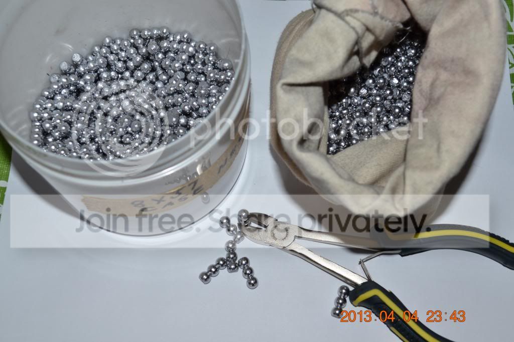

Next I ordered up a Buckshot mould. This turned out to be the slowest and most costly to produce. The mould is twice the cost of the slug mould by the time you add the handles.
I originally wanted to do 00 Buck. The mould makes 18 balls enough for two loads. Sounds great! However I could not find a 00 Buck mould and settled for #4 Buck.
Thinking I could load a bunch of #4 while I waited to find a “00”
#4 Buck: The mould also makes 18 balls however my loads used 25 balls so casting took a lot longer than I thought. I used the Downrange WAD 12ga 1-1/4 YELLOW (WAA12F114) Then there was the next surprise. The Lee mould makes 6 linked strips of three balls. You have to cut them apart. Well…..any idea how long it takes to cut 25lbs of #4 Buck up with a set of flush cutting pliers????? Not only that but I also had to count or weigh every load.......now a hundred is an all night affair.

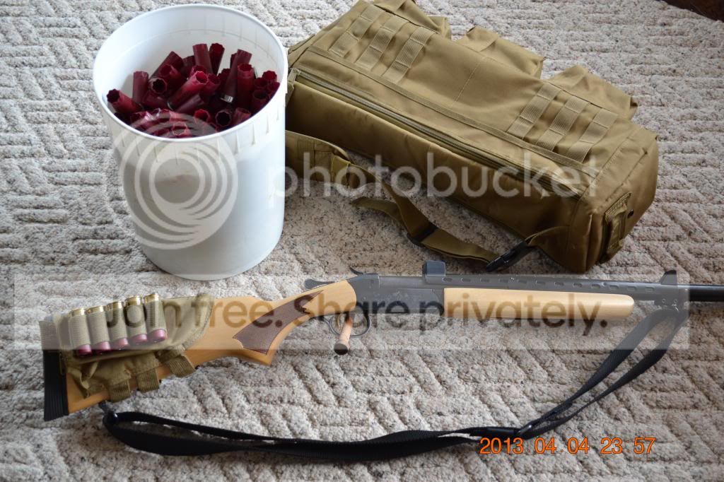

I did choose to buy a cheap shotgun to do my load development with.
I bought a Winchester 37a off the EE and cut the barrel off to shoot slugs.
I then read derekb’s thread about his barrel cut down.
http://www.canadiangunnutz.com/forum/showthread.php?867790-Barrel-Cutdown-from-26-quot-to-22-quot-to-achieve-Cylinder-Bore-Pics&highlight=single+shot

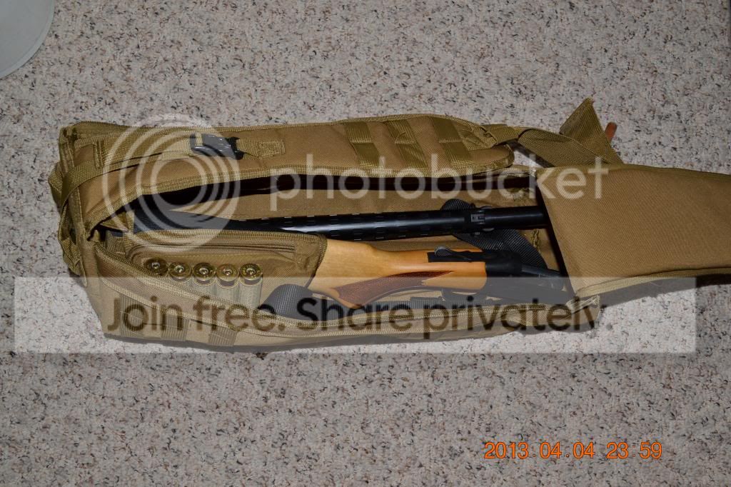

I looked in my box-o-crap and decided to make a more usable shooter under the premise of re-purposing leftovers with a zero budget.
Everything is a used take off that is added to the shotgun.
That ATI heat shield looks goofy, but provides a great set of ghost sights, and believe it or not gets hot with all the ammo I have to shoot.
The bag was kicking around and it all fit together nicely.
Combined with near endless slug ammo this little 37a has been a big thrill to shoot. In fact the nice shotguns are all gathering dust as my beater has really grown on me.
