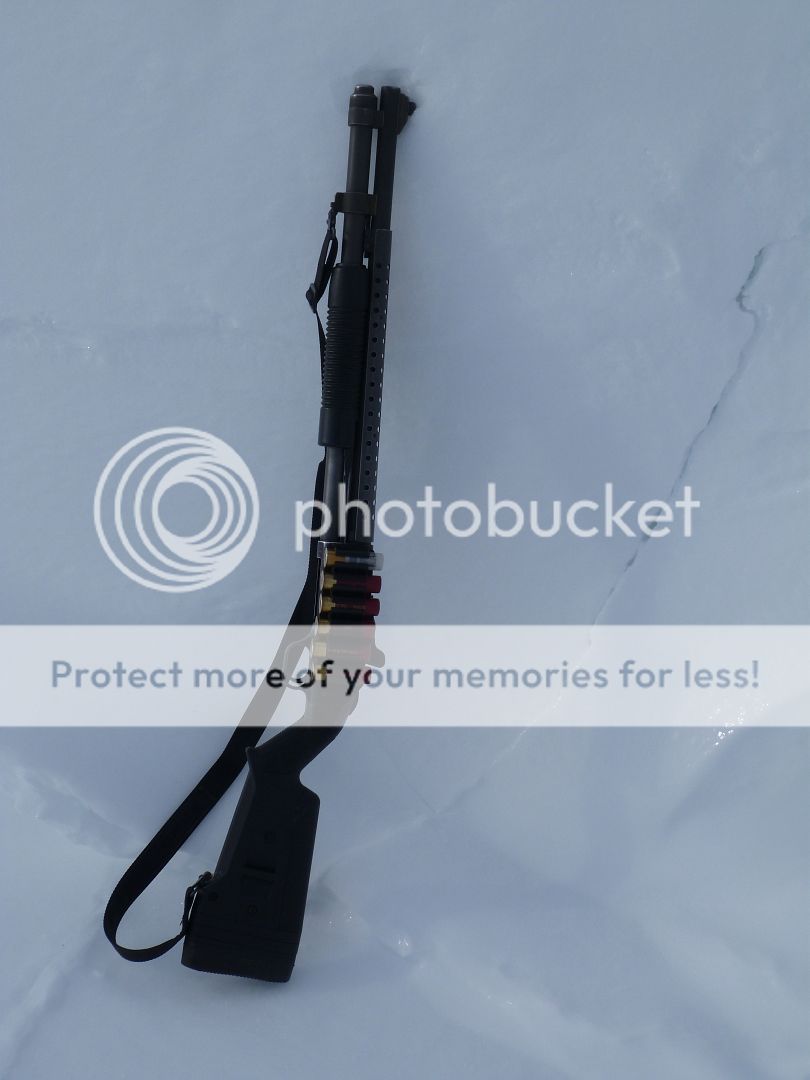

H7VXC_Yjd8Dc359slnteEZf6g2hpoieb-P8-MX41mfB8DGK3OsuWg5EJqUrog8-9zFgFiI8WIqehfEcojCx1whWB2MbsQq3LXxWVuo9XAJVChtjw0L-gjLCwsYc0CCaBQE_yod6OSKyMX2qofGLfI9Y6AoKLQdqUkV5hoCmNq6IiR0sFYOvLfJ2_KBtjlOebGYyOEeeCAvDuPYXJW2ZWgbnv6DmGlas1a3et2LC7xrM5HlY5qQUK3BLO0F4WN8CBlmsXzUhP3wBG-8cHZSh7_I-DjfxOIKIqcKvHpaASEKiN8FswD32YLKySUx_gR9KWspsU9Kn4TnOwzIkRpoD1JLhnITrnDAWoJu78SZOEYlhSudAxGxqvxhZdsVyjx5Gwbwztfq_g1K2gi07h-4ZbYIlLRjEaRfu7QdUgYDKVO4-QNMmU3DhjBYPY6UT0Yjw8YouV-eEKfRkk6O-kt4j1s4aFa6nB-pQcKa1tpdjtmkWyFfCMAB3QJekL8K1jtefb046Ai1XDvjLaHCfRfrNjKAurNVcRNL0hp3GmxoO6o7XqUl4amalISmigJVT_qPyoQEVCyyCWcBcUOAw5KdJ1ZcZ3yLXLjkq5YxTPXNtP9EcuzPllIkNXxz-yB7bkAzIxTeDcu6xv98cFci-byONidOM8KiaL2XNC=w1920-h960-no

Get the Canuck Commander. I own one. Solid shotty. I also have a cut down 870 Wingmaster from the 1970's all Magpul stock options on it. I've owned a Defender. Got bored with it fast, and sold it. The Canuck will serve you well. I've put near a thousand rounds through mine. Not a single issue to date. Try that with other shotguns. You'll get issues. For what you get and how it operates, I think you can't go wrong with the Commander.
