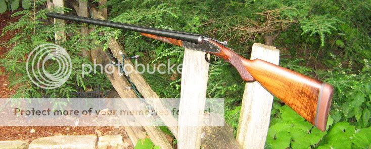

You are right Frank. I have a 16 ga Tobin as well and it is 2 9/16 chamber. I shoot 2 1/2" shells in it because I love it and don't want to abuse it. I was told that the black Remington 16ga shells were ok because they are actually a bit shorter than 2 3/4". I don't bother though. Here it is. 16 guage "black diamond" model with exceptional wood.

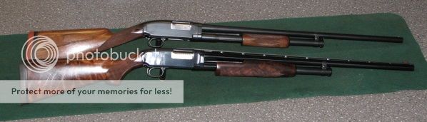

I LOVE the 16ga. I came to it later in life and appreciate it in guns scaled to it. My favourite is the 16ga Winchester model 12. I have two.
The straight stocked one is a nickel steel with a short chamber (but it does cycle those Remingtons). The bottom one I customized with a new stock and rib. It also has Briley chokes. Its my go-to upland gun.
