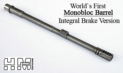

Hey guys i figured id throw this out there because you always take customer advice to heart (which we really appreciate); have you considered getting some AR barrels made that are 18.6" but include integrated muzzle brakes/flash hiders (i.e. machined directly into the barrel)?
An example of this would be the factory barrel on the AR 180b, or the FAXON barrels that have the integrated flash hider (pictured). This essentially allows you to save the length youd have to give up by adding one of those devices, while maintaining the 18.5" minimum length barrel required for a rifle to be Non Restricted.

Interested.
Tried, IBI and MRA already and no dice!
Let’s keep it 18.6” Including muzzle device tho.

Ahh welding an insert yes but not if the muzzle device is part of the barrel or built with the barrel in mind.
The rifling doesn’t matter as long the barrel, in one piece is a total of 18.55 inches or more.
Interesting, I had a NR ACR with a flash hider machined into the barrel. Rifling ended at 16.5 inches and RCMP approved it for NR status. I even emailed them to confirm and I got a response saying "if it was machined in one piece, then it is fine as long as the overall length of the barrel was 18.5" (which mine was 19" with flash hider).

No, it doesn't have to include rifling. The example you cite is adding a piece to the barrel, not having a continuous barrel to the end of an integrated comp or flash suppressor.
Herron Arms did barrels exactly like the OP is requesting and they are perfectly legal.

Welding on isnt the same as manufactured as.

Barrel length is muzzle to breechface.

I have thought about this in the past as well. I'm not a 100% sure if the Faxon barrels arre 'integral' in the Canadian sense or in the US sense with pined/welded muzzle devices.
https://www.thefirearmblog.com/blog...barrels-flash-hiders-muzzle-brakes-shot-2017/
But realistically with this type of thing your best bet is to save yourself a lot of hassle, time and frustration and just get a custom one made in Canada. Trying to group buy or convince a manufacturer to build something like this is near pointless. You might have 20 people interested, and when realistic custom pricing comes out only 5 will pony up the cash, so most manufacturers won't touch this, not worth their time.
