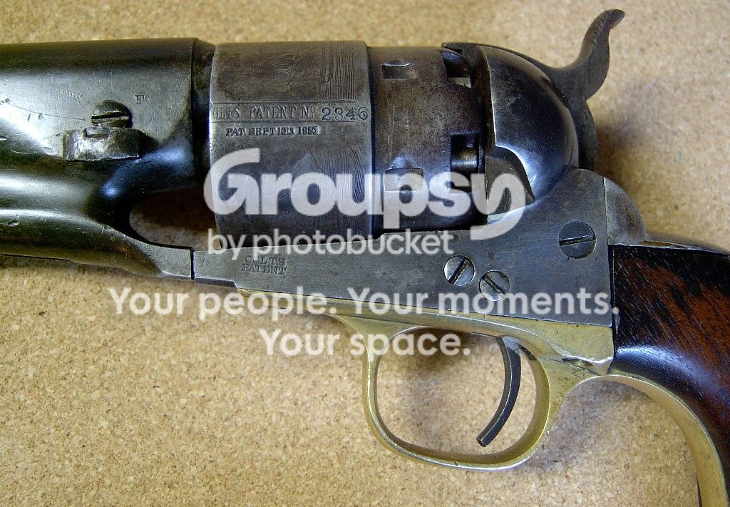

For what it is worth, the D.C. Sage cartridge packets shown below indicate
18 grs. for .44 cal Colt's Army pistol and 17 grs. for .36 cal Colt's Navy pistol.
As smellie suggested in another thread this was what both sides used during the CW.
Are current BP shooters using more than they need...I am sure that I don't know.
These cartridge packets do not belong to me.
I personally would not overload these old guys if I was going to shoot them....which I won't.
Perhaps not as critical with the modern guns?
