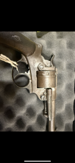

Hello, I have recently just bought an antique status 1873 mas revolver. It is chambered in 45 acp. It works good it is only just missing the trigger return spring. I have attached a picture of that part. Does anybody have one or has made one? Thank you.

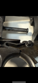

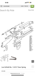

For anybody in the future. The sear catch spring from a lee enfield fits perfect. Just cut slightly shorter and sanded the sides down to prevent the frame from pressing on it.
