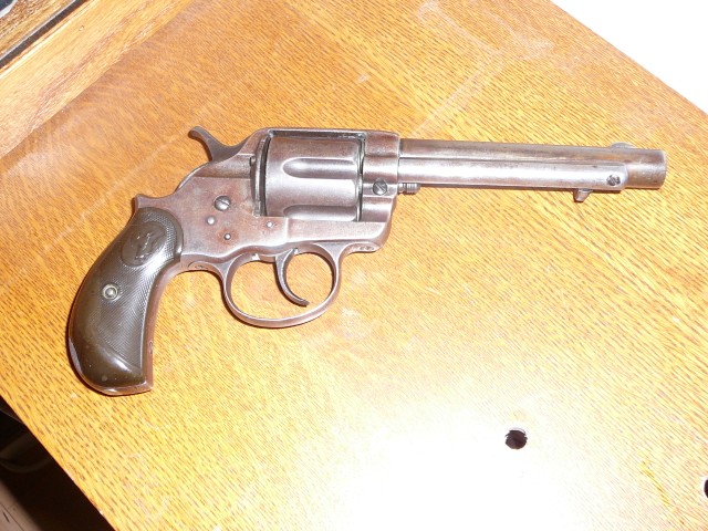

I received this in the mail, shipped Jan. 17. Arrived, Jan 29. 4 days in customs. I had heard things were really tightened up at the border??? Sent from Eastern States, went smooth.
Anyhow, it needs a bit of hand work. Are there parts around? I would like to start with a new hand, maybe repro grips, and a swivel. !885, .44 Russian.

www.coltparts.com used to have parts for theses. give them a try I think they have new hands you might need a new hand spring as well.
if its just poor timing check the stud in the loading gate. they get worn outa round and are important for correct timing. there a lot easyer to fix than replaceing a hand.
you can make a new round stud from drill rod . look close at the inside face of the loading gate you will see the stud that's just pressed in there.
Also the loading gate should move in and out as the cylinder turns if its not doing that you need a new loading gate spring and that's a big job to replace.
but as long as the gate stays shut on its own and theres slight spring tension the last 1/4 inch or so its good don't mess with it.
