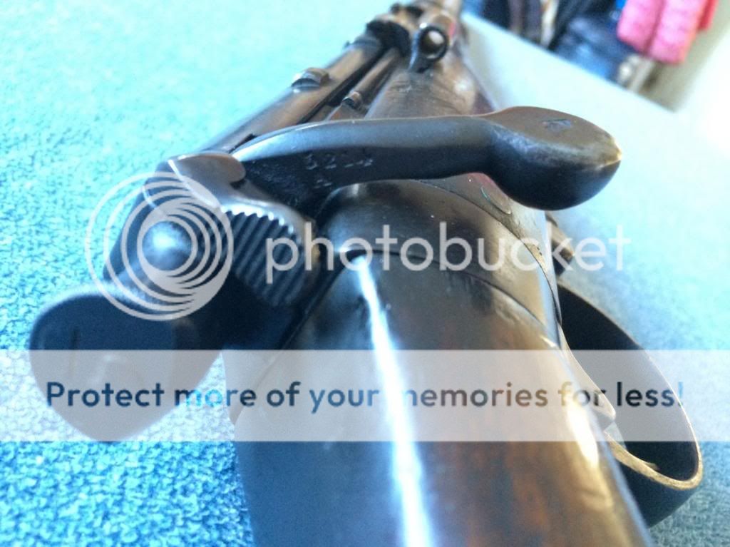

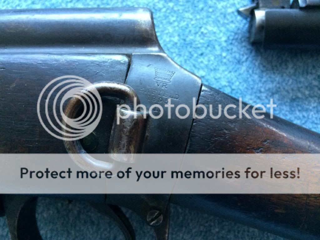

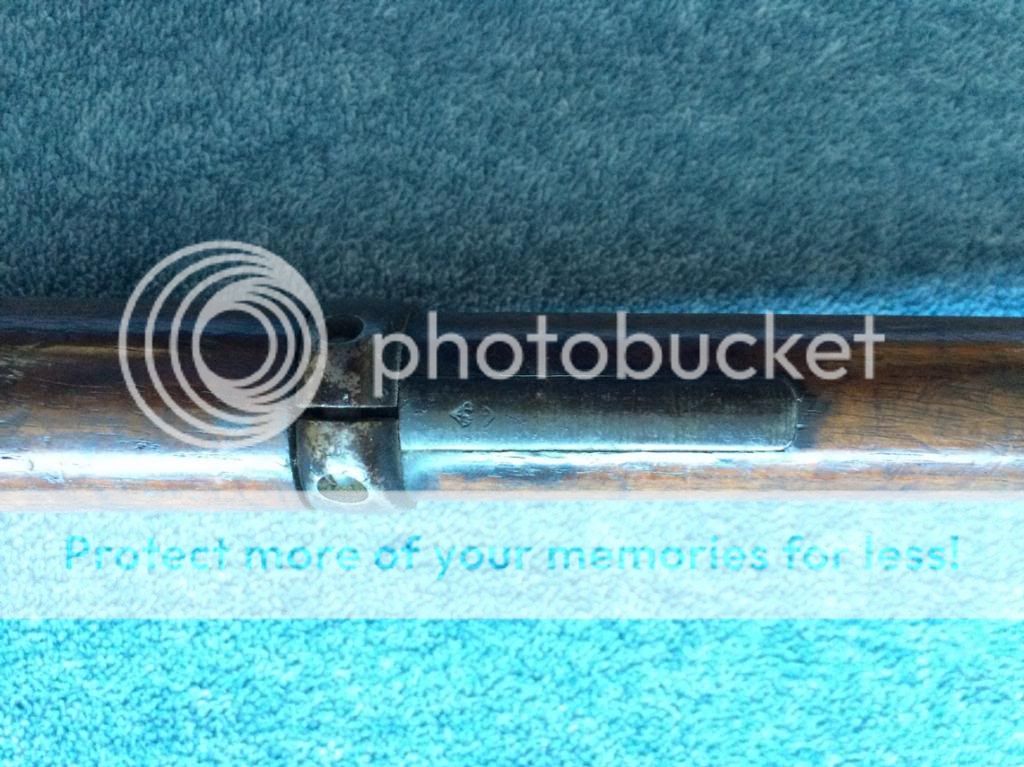

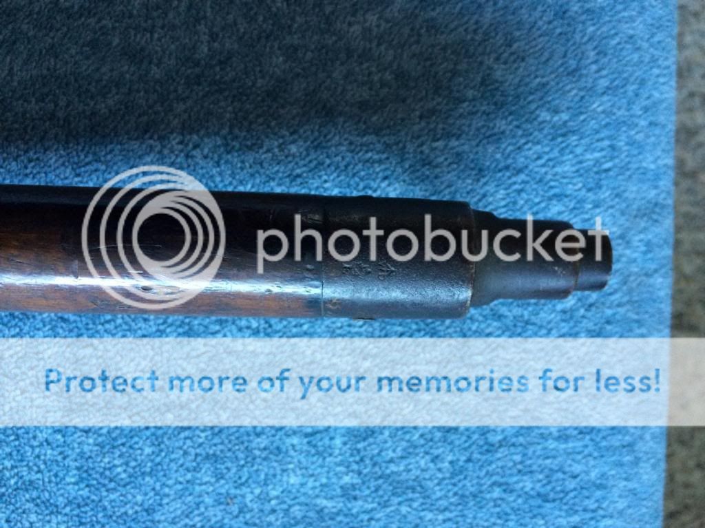

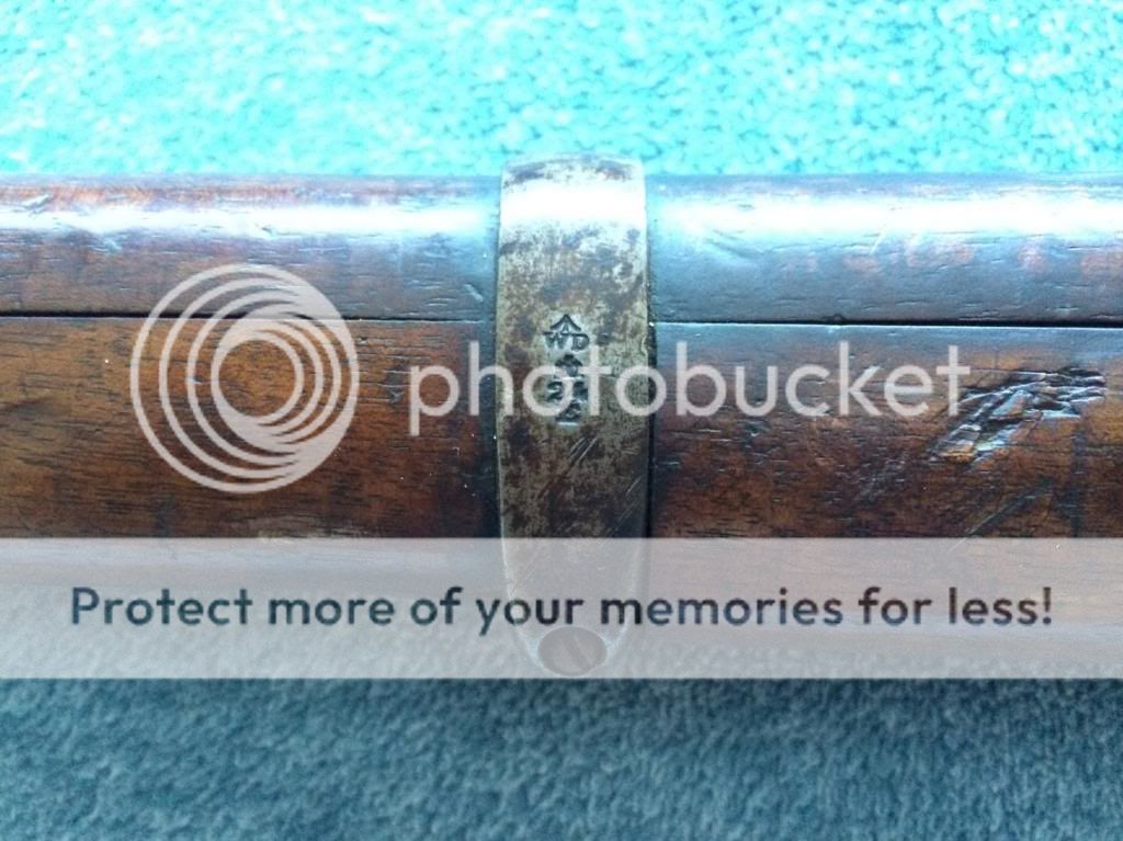

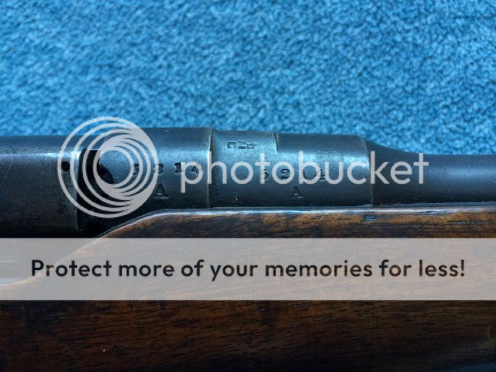

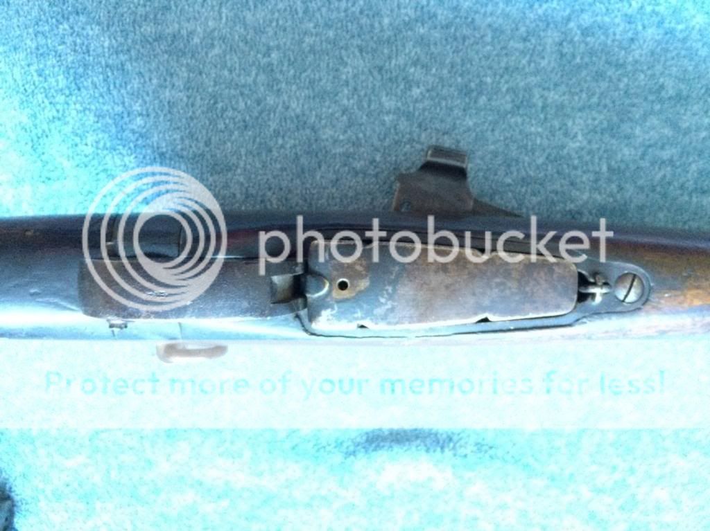

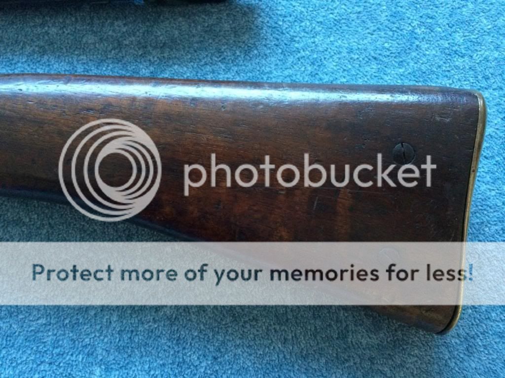

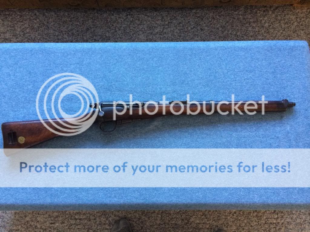

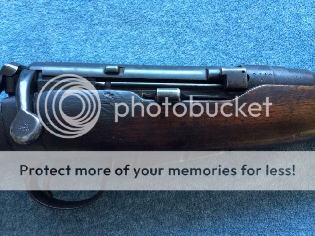

Hey guys, I picked this little gem up at the Chilliwack gun show. The markings and general layout indicate that it is an unmolested 1895 Lee Metford Cavalry Carbine Mk I. The carbine is numbers matching with the magazine cut-off, D-ring, chain link on the magazine and carbine nose. The bore is worn but not pitted and there is no cleaning rod.

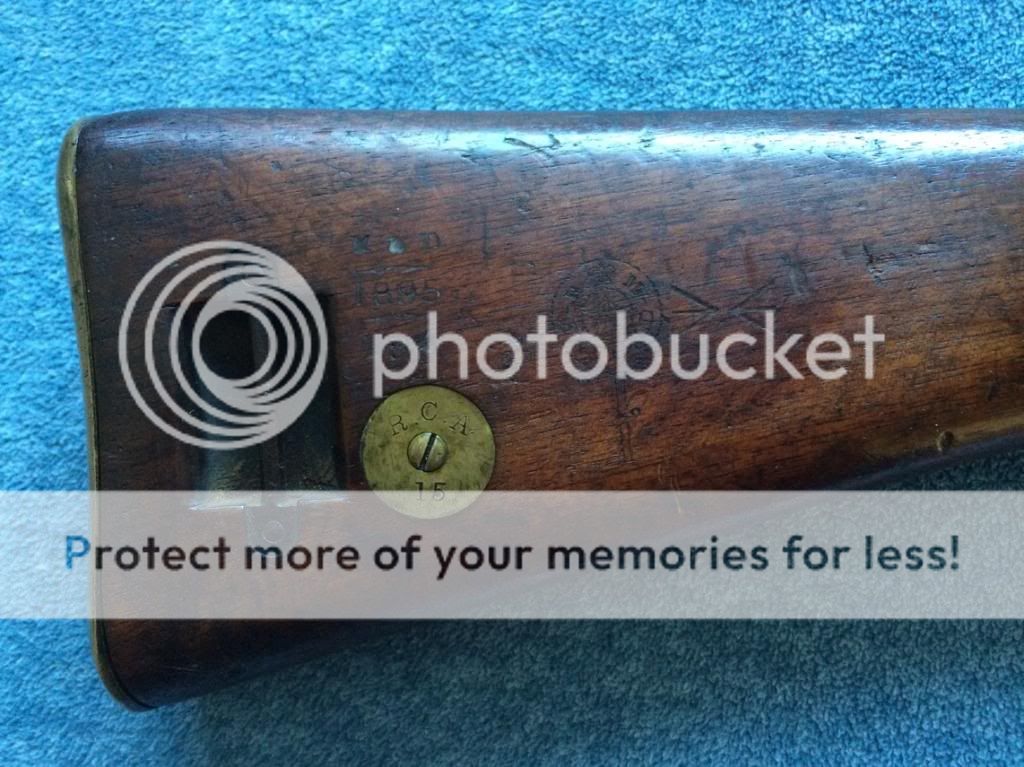

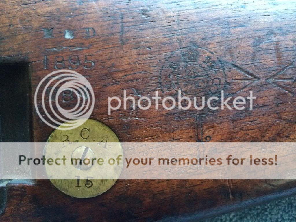

Here's were I could really use some help from the experts. The regimental disk is marked "RCA" which indicates that it may have served with the Royal Canadian Artillery (Regiment 15 maybe?). I've read that only 500 of these were brought into Canada, but would like to find out for sure if that's accurate. Is there any way of knowing if it served over seas? How many of these are likely to have survived in original configuration? I would greatly appreciate it if those much more knowledgeable than me could explain a bit of its history and provide any other useful information. Thanks!

The bore may not be too bad, Metford rifleling is like gentle hills & valleys compared to Enfield's lands & grooves & tend to look like a worn barrel.
Looks to be a very nice score, they are pretty rare especially with matching numbers & a intact D ring, well done.
Very nice carbine. I think you will find the rack # is the 234 or 284 stamped on the butt. Rack # 177 was issued to R.C.A. Field Battery # 8, which I believe was stationed in Gananoque, Ont in 1895. It will be interesting to discover the significance of the "15" on the regimental disc.
B_noser. Nice little tidbit of information. RCA Field Battery 8 in Ganonoque? How do tell? I have an 1896 Lee Enfield carbine rack #33 marked to RCFA Battery E. They were mobilised in 1900 and saw action in S.Africa. If marked on a gun, could your 8 be an E?
englishman: I am by no means a military historian and welcome correction anywhere I might go astray.
I have LMC rack # 177 and have done a little research into it's history. My understanding is 500 LMC1s were delivered to Canada in 1895, and the first 200 of those went to R.N.W.M.P. Since my rack # 177 falls within the first 200, those issued to R.N.W.M.P would appear to have not been consecutive rack numbers. All of the Canadian LMC1s I have seen referenced have had serial numbers in the 5### range.
Subsequent deliveries of carbines to Canada were LEC1s and, as I recall, they were delivered in two lots starting in 1896.
The regimental disc on mine is stamped R.C.A. 8. A little research into the Royal Canadian Artillery indicated the only unit with an "8" designation in 1895 was Field Battery # 8, and they were stationed in Gananoque, Ont. in 1895. I cannot guarantee the accuracy of my conclusions, but do have a high degree of confidence. If my conclusions are inaccurate, I would welcome correction.
