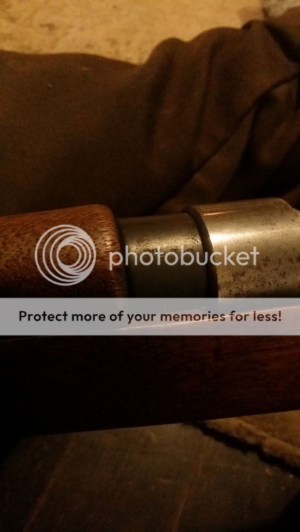

Ok just a quick update...
I go thte barrel off, that required 3 days soaking with brake free and then a little heat with the heat gun and a few whacks with a hammer.
so there is a little pitting on the barrel shank and a whole lot of crusty old cosmoline.
I have made a few inquires on who can do the threading and may have someone who is willing to take on the 3 TPI Left hand thread, so I will look for an acceptable barrel to use and see how it turns out.
thats plan A.
Plan B is is either a rebore, but the barrel is not that nice on the outside either, or just using the shank as a sleeve.
