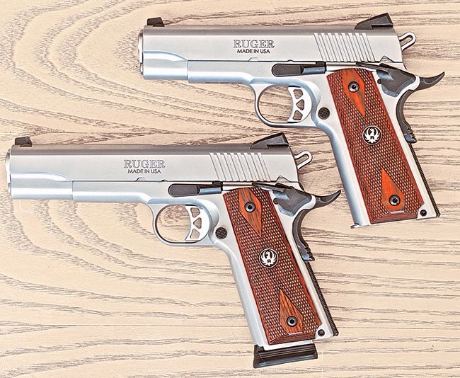

Commander on top, Gov't on the bottom
Slide and barrel: different
Frame: same? looks very similar, but if you measure it on your screen the dust cover appears approx 1/4" shorter on the commander.

Thanks for that pic. I had indeed compared rhe frame length in photoshop, and youre right.

Sorry, I don't own both, I just found the picture on line. I only have the SR1911 Gov't model. I'm pretty sure you can use either frame on either slide from a functional point of view. However the dust cover will either be too short (leaving a gap) or too long.
