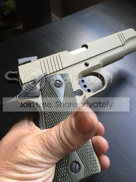

Noob to the 1911... what's the "horn" and why is it beneficial to remove it?
The "horn" is anything on the gun that is sharp that you don't want to get gouged or cut by. I had a Stainless Colt Gold Cup from the "80's" where just about every edge was like a knife. No radius as all. It required a fair bit of dehorning to make it even remotely comfortable. If you haven't seen a gun with sharp edges it is hard to imagine that they can ship that way, and just how painful those machined edges can be before they are smoothed into a large radius corner. Make sense?

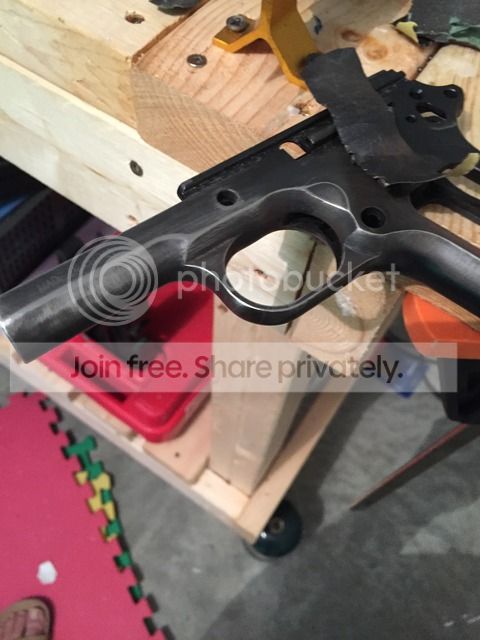

But if I’m modding for performance, trigger job for example, the gun is apart anyway so a little inside cleanup, as well as deburring/dehorning, wouldn’t add much more build time. Deburring may need only a few strokes of emery paper, which would smooth out the rough edge or burrs, of a sharp corner. Dehorning is more involved requiring more tools and skill to do a good job to look like a Kimber Stainless Target or Dan Wesson.

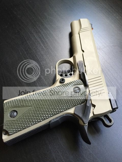

Btw, nice job there, OP. You’ll enjoy shooting that piece more.
If you start getting cut when shooting a gun, the blood will interfere with your grip and it now moves from a ‘comfort’ issue to a ‘performance’ issue. Lol!
Nice job, OP. :cheers:
