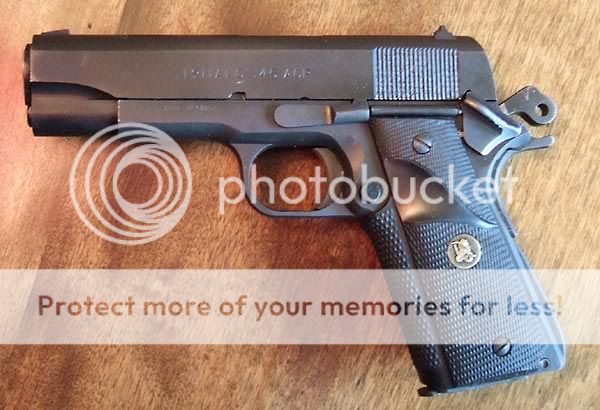

I'm resurrecting this thread to post a few comments on my Armco-tuned 1911A1C that showed up today. I agree with Bruiseleee's comments that a 5" is probably a better starting gun, but I already had a 5" Colt so I wanted to try something a little different.
It's the first time I've handled a Commander-length 1991...I'm really surprised at how difference the balance is than a 5" model. It feels very nice in the hands, actually maybe a little better balanced I think, than a standard length. The trigger is very nice--crisp and light, and the stock sights are pretty good, too--low-profile but still provide a good sight picture. I was also pleasantly surprised at how tight it is--no rattle at all!
All in all I'm very pleased--hopefully I'll get some range time this weekend!

I had my Compact (as seen in post #22) out to the range last evening and I was very impressed. The pistol's accuracy was probably the most surprising thing--even with the stock sights. Two-handed standing 15m groups were about 1.5"...double taps were easy and pleasant to shoot. I haven't fired my 5" Colt since last year, but it really seemed that the Compact recoiled less, which was quite surprising since I was expecting more kick. I figure it's either my imagination or maybe the lower slide mass helps (or maybe I've been shooting polymer-framed guns too much!). Any thoughts?
