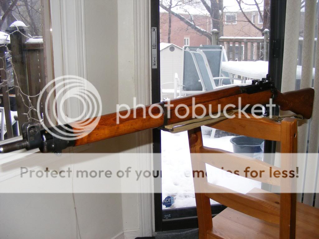

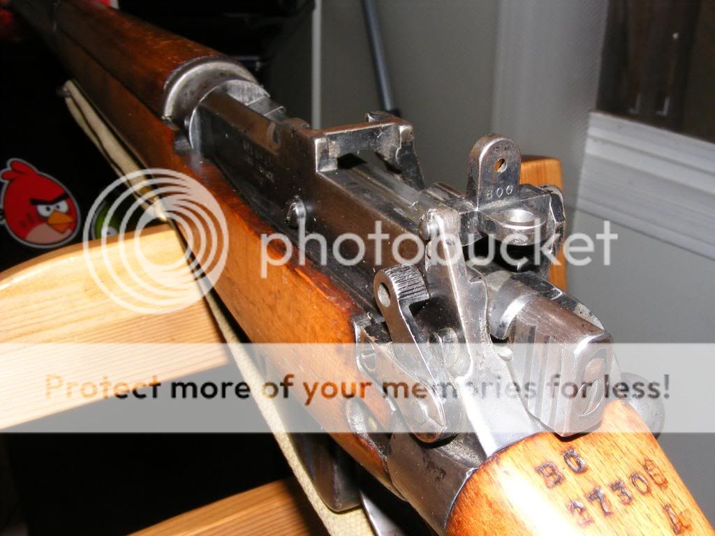

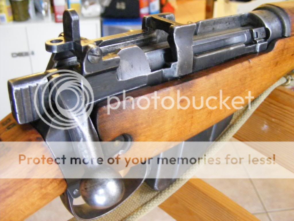

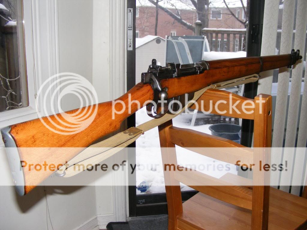

So I got it all finished tonight, Someone in previous years painted all the metal, Took me a couple hours with some steels wool and it took most of it off. Suprising the bluing under it wasnt that bad. My plan was to make it look like it was issued and I think that happend. After I took a look at the bore, I found it was MINT, 6 groove longbranch barrel. Looks like it just came out of the factory. Also had a chance to check the headspace, turned out to be very good on a 0 bolt head. Found myself a 1942 C broad arrow sling in my misc. box to finish off the build.
Anyways, this is what she looks like now, I havent had a chance to look for heavy bands so I through on a set of smaller ones that I had laying around.
I have a S&K mount I may through on it and turn it into a sniper kind of thing. I think with the 6 groove, it would very accurate.
Looks very nice and period! You're going to hate me when I tell you that you missed a milled Long Branch Mk 1 sight in the EE a couple days ago (so did I) - it was attached to an AIA rifle, and I nearly crapped a square red rock when I looked at the photos and saw the early LB marked sight! Alas, the ad was marked SPF so somebody will get a surprise when the find out the sight is something special!
