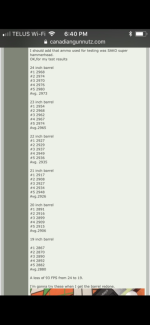

Oh ya then a 20" barrel is all you need and it'll be much nicer to move around with. I have a .308 with a 16" and it's so nice to hunt big bush with.I would be using this rifle under what I call normal hunting conditions and distances. Most of my shots are under 120 yrds, but would shoot as far as 200 yrds max.
Not refuting what you have said, but I must add that I have many with 21 inch barrels that shoot well under an inch, and chrony quite high with the right load. I love the H&H as a cartridge. I am getting 2700fps out of a 300g bullet, hot load -yes in a 21.5" barreled Model 70 and it shoots 5/8" all day long. Several of my custom Rugers do the same.I'll be the dissenting voice. Short barrels have become very stylish for hunting rifles recently, and have a lot of supporters. Not me.
I have ( and like) a couple of rifles with 20" and 18" barrels. For me they are specialized tools that definitely give up some performance in order to increase "handiness".
