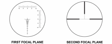

Personally it matters as with at least above standard velocity the lowest rungs of my internal scope ladder allows me to set it on the frying pan at 300m . Wind is also ridiculous and anything that get it there asap is a bonus . These are obviously extremes when it comes to RimFire but applicable in our experience
