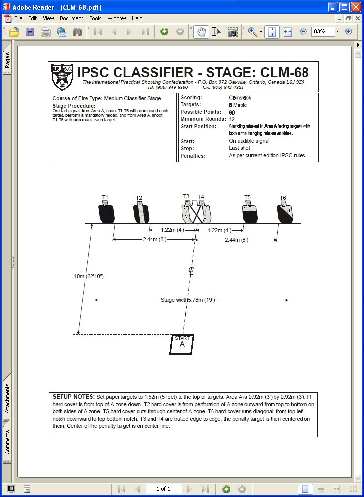

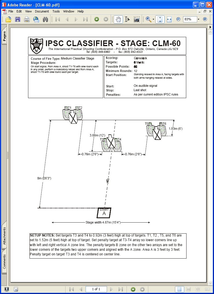

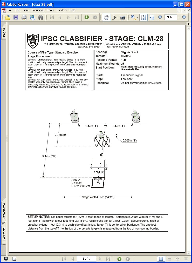

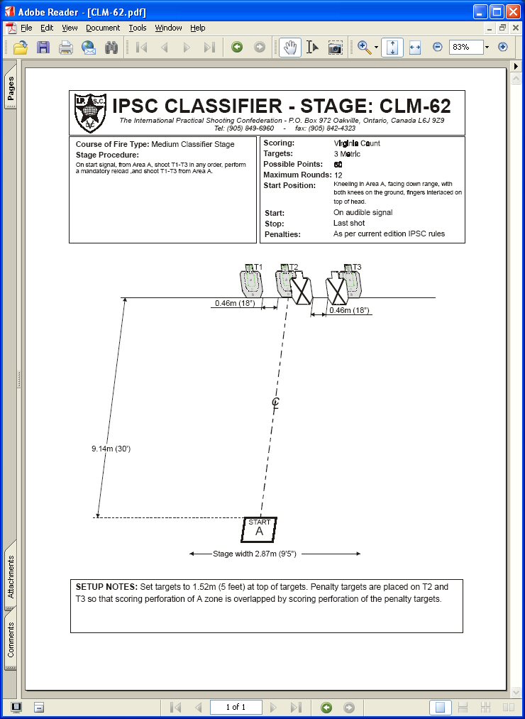

Ohh, and just for the interest of those watching... These are the 4 stages which have given IPSC1 his 100% Canadian average, and which the rest of us are scored relative to. Isn't it nice how they are so representative of the type of ipsc we shoot here (just check out the stage procedure on the first one, for a good laugh).
How nice... lots of 'shoot 1 shot per target, reload, shoot 1 shot per target, all while standing still in a box.' Yup, those definitely produce correct classifications for the Nationals... We just need to get more clubs to setup these stages, and everything will be just great.
As much as I respect ipsc1 and his shooting ability, I'm inclined to believe that his 100% WORLD WIDE on 3 out of those 4 (never mind his #2 in the world ranking) is due to none of the top Prod people in the world shooting such ridiculously stupid and contrived stages, rather than his ability to outshoot everyone in the world.
