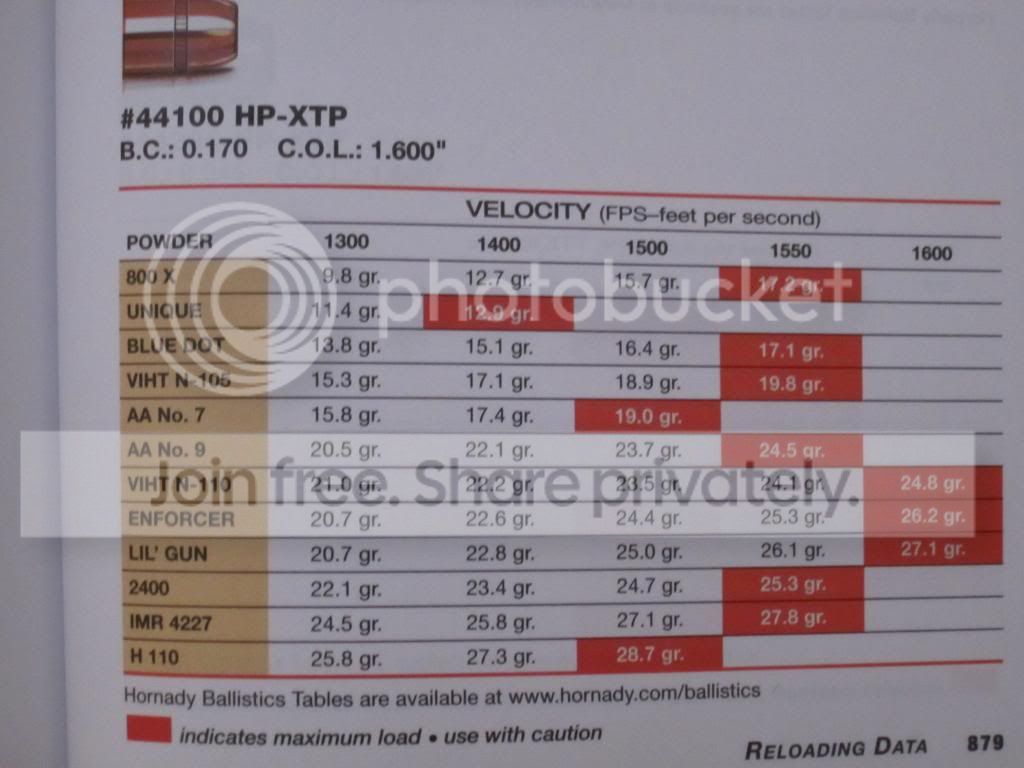

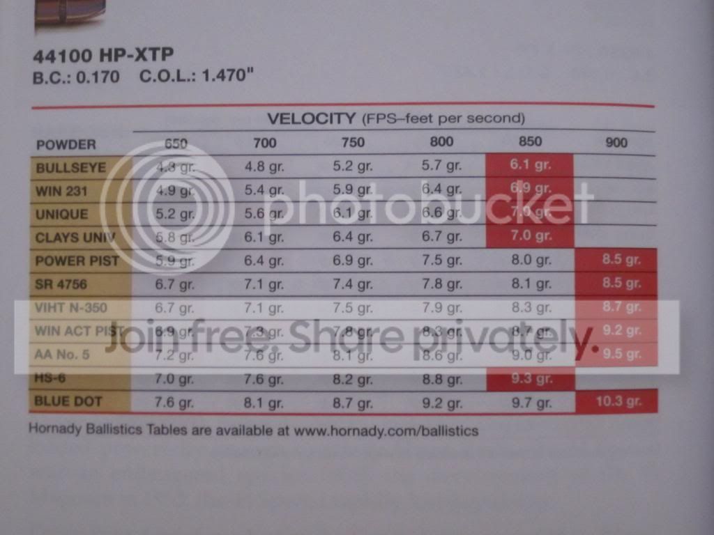

I've read in two articles and one reload manual that say xtp bullets can/may cause pressure problems. I don't have a Hornady load manual, and if I buy another manual I'll be sleeping with the dog. I'm thinking that I can use start loads for any JHP bullet but I'd like to be sure. Has anyone got Hornady's manual who'd like to share the load data?
44 mag-
44 SPL-
(sorry the bullet isn't in the pic but you can see the part number which is 200 gr xtp)
Fall Guy I have the bullets I wanted to make sure I was on the right track load wise.
Bollox thank you, this info lets me know for sure and also allows me to compare load data to what little I've found so far.

OldDude I had the same thoughts. The Lee load book, and one article I read, states do to the design of the XTP bullet in certain calibers and loads the bullet seats deeper and can up pressures. Bollox posting the actual Hornady loads gave me the opportunity to confirm what you're saying, about start loads, and what I was thinking. I did not think the loads would be that far off JHP loads but better safe then sorry.
