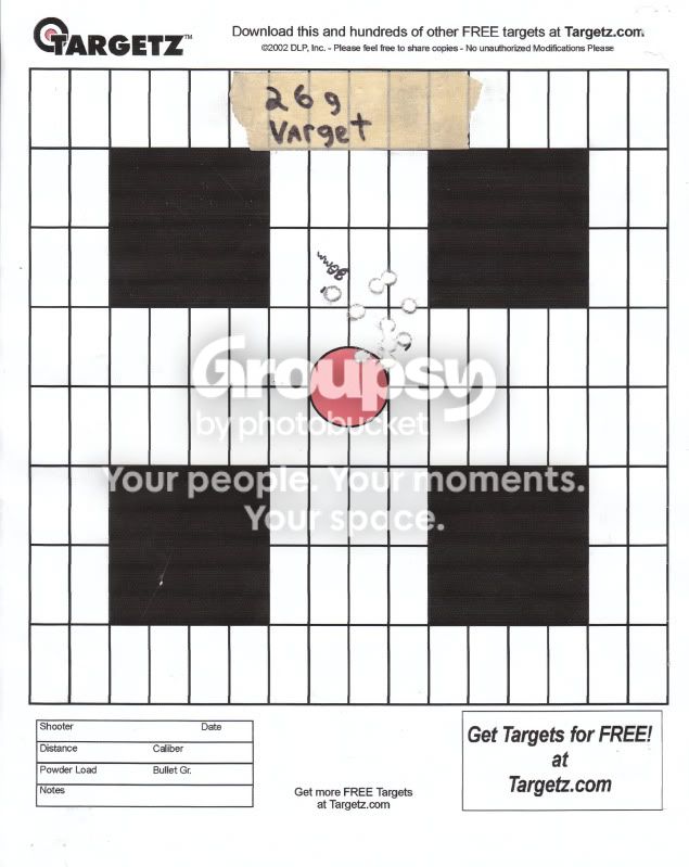

Time to share the embarrassment....:redface:
I did mange to get three in a 0.5" hole on Sunday (39g SBK's) and was quite happy. The pic for this is below but you have to see the 40gVmax first....
Then this is my results with the 40GVmax
and
After I shot these, I put one 39g SBK in the chamber and put it a little over a half and inch away from the nice group of 3 that I mentioned above. I should have stopped at 3, but still a good group.
These were two weeks ago with the SBK's
I don't think this is very good advertisement for me selling/trading these on the EE...f:P:2::slap:

Good shooting pal.:redface: You got the names of the guys that shoot the 40gr. on this thread. You could sell the bullets left over from this learning experience.:cool:

SKS, what gun are you shooting? My SPS with the 1-12 twist also grouped the 40gr Vmaxes poorly. It shoots much better with 35gr Bergers and 32gr Vmaxes-although the speeds are much slower than published data.
