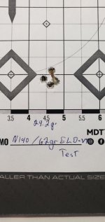

N140 - 29.2grs
62gr ELD-VT
3100 fps.
5 shots under 1/2 moa=
Still working on other load but this seems to work very well.
