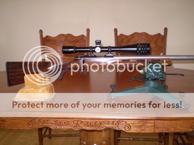

How good can you get with a .22LR is a question I have been trying to answer myself. I must admit I get no-where near 0.5 moa at 100 yards, but I have only been working on this for a couple of months. The rifle I have is a Ruger 77-22 action on a Lilja heavy bbl and a pillar bedded Richards microfit stock.
So far this is the best I can get with Lapua ammo, this is my best for 20, 10 round groups shot over about a month period, mostly with a 2-5km wind.
I have not gone to a bbl tuner as yet, just trying to learn this game..
Rifle
Groups
Very nice rifle Robert.
That looks like range 3 at Sharon Gun Club, hope to see you & the Ruger there some day.:)
Yes it is range 3, I hope to get out this saturday and join the range 4 club and shoot at 200M, I just competed my range 4 qualifications!
I was thinking the same thing. Hope to get out saturday myself, maybe we'll do some shooting together.
Interested in taking a closer look at that rifle Roberti, looks very cool!
