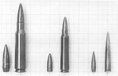

The Swedes were developing the .22 Magnum into a PDW cartridge in the 1970's. The idea went nowhere but they tested the proprietary cartridge out to 300m & beyond. Supposedly the round could penetrate a steel helmet at 300m. It was .17 calibre, the bullets were made of cold formed copper wire.
The gun itself was fairly sophisticated having 3 rnd. burst, locked breech & fired from an open bolt, 1800r/min, with 50 rnd disposable magazines.. It sounds like the cartridge may have used a proprietary powder to get the mv up to 1000 m/s. The Swedes know.
