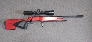

Sounds like you have the skills for the TLC needed to get a Scorpio up and running. I have tested a number several years back and those ones shot really well with SK rifle match and Lapua CenterX. If you research what these rifles are clones off, this ammo result will make sense.
Now QC is all over the map. Biggest issue is ejection and the extractor claw. They can be worked on to function 100%. Some batches are better then others.
For the scope base, I used a modified MDT CZ452 and milled the top of the receiver. There are Annie bases that might work but you want an old style 54.... hint, hint.
Some barrels come threaded 1/2-20 and I added a 'tuner'. combo has done well for me with even a podium finish despite limited competitions with it.20230928_081645.jpg
If you want to machine and install a match barrel, the shorty 332X is the one to choose as they come ready for barrel swaps. Better QC wrt to extraction and ejection, have large bolt knob and pic rail. I just found these barrels to not shoot as well as the longer barreled 332A.
note the 332A have 6 grooves.... 332X are multigroove like Marlins (?)

Awesome looking rig Meroh. Do you favour the straight grip?>
For benchrest, yes I do. Not really gripping it but using it to locate my trigger finger. Chassis came with a very nice MDT pistol grip, but it did not really fit me all that well; I had a rather plane AR grip on it for a while, and it was not quite right. This grip is the cheaper option from MDT and compared to their product line, this is not built all that well, but once set up, it is working just fine for me.

Some barrels come threaded 1/2-20 and I added a 'tuner'. combo has done well for me with even a podium finish despite limited competitions with it.View attachment 938958

If you're looking for something fancy like the cool kids have with an aluminum chassis and a truck axle barrel, you can stop reading here. If you're ok doing some tinkering, the suggestion of a Scorpio is great. Here's my son's rifle, shortened the stock for him by almost an inch, added a nice long ARCA rail from amazon with some JB wend and machine screws, made a bigger bolt knob, cleaned up the crown and smoothed the action, 3d printed some 2 round mags extensions so they hold 12 now, trigger job, made a cheek riser from a plastic bucket.
This target was 10 rounds of SK standard plus at 100m. The flyer was my fault, the bipod slid on the bench at just the wrong time. The base rifle is definitely a bit rough when you get it, sort of like the manufacturer did 90% of the work to build a great rifle, then sells it for 1/3 or 1/4 of what a great rifle would cost. It's no cz, but I would take a Scorpio over a Savage any day, even if they cost the same.
