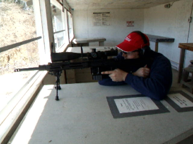

This is an older pic of the gun that did it:
More info: http://www.jprifles.com/NewJP_CTR02.php - look for "CTR-UA"
I didn't know whether this was a Reloading story or a Black Rifles story, well it's a little of both. Either way, I'm amazed that a progressive could spit out ammo that would do this in a Black Rifle.
