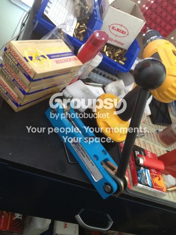

#1 swageing primer pockets:
95% of the .223 brass I have put my hands on has a crimped primer, infact I sell most of my commercial brass and buy Mil just for the simple reason of knowing what to expect with every piece!
There are many options for getting rid of that pesky crimp
drill and chamfer tool, RCBS swager die, sharp knife etc etc
The common thread with all options is time, every time you add another step where you handle all your cases your adding time... I can run a single case thru my dillon super swager in 5 seconds...
That's
12 cases per min
120 cases per 10min
720 cases per hour
4,320 cases per 6hr's
....not counting time spent moving brass in the bins, refilling beer, counting the holes in my peg board on the back of my bench....
The 1050 does it every time you pull the handle and costs $2000
The super swager is $120
