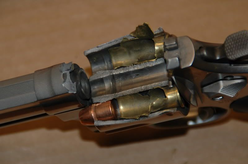

Detonation of small charges of powder in big cases can and does happen. The primary mechanism is though to be the incomplete ignition of nitroglycerin containing double base powders. The powder smolders, releasing the nitro as a vapour which then causes a high order detonation.
In the 25 years I have been around guns, I have personally seen three revolvers that ended up looking like this. Every one of them was a 44 Mag. Is that coincidence or is this the result of a detonation event due to a small powder charge in a large case? I don't know the answer but I am not a big believer in coincidence.
I have never had an issue with loads of pistol powder in a rifle case; I am not sure what issues there might be.
Dale Earnhart said exactly the same thing about basal skull fracture before he died of a basal skull fracture. That it has never gone wrong for you is completely irrelevant. It can happen and to ignor that fact is stupidity.
