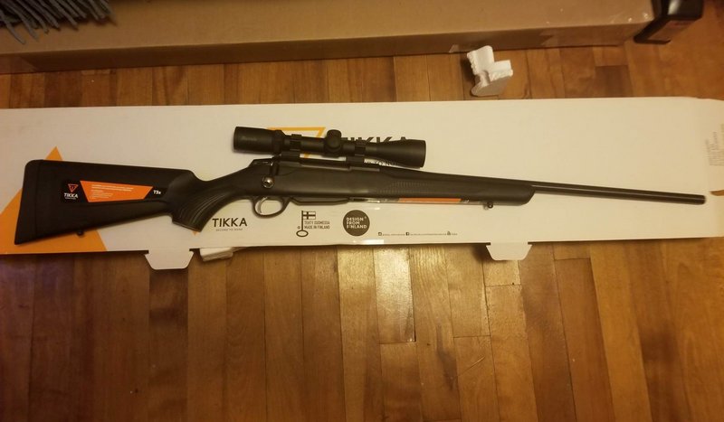

Stopped at Cabelas on the way back to work and the real world and a 223 Rem followed me home. As I looked at it a while ago, was giving some serious thought to having it reamed to 223AI but maybe I'll just put that money into optics or ammo.
Dan, those 788s sure sound like they shoot. Sounds like it is definitely time to build another :p
