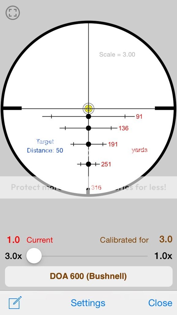

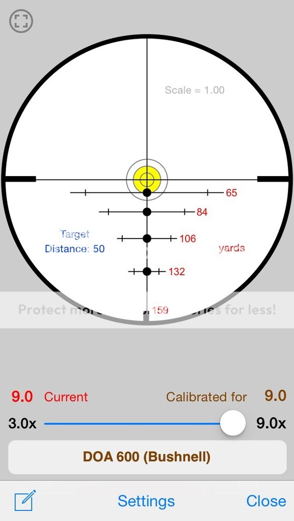

Bushnell 3-9 x 40
DOA 600 reticule
Sighted in for .20gr CCI/v-max @ 100 yds.
Can be found for less than 250$ Easily (179.00 Cambodian Tire)
