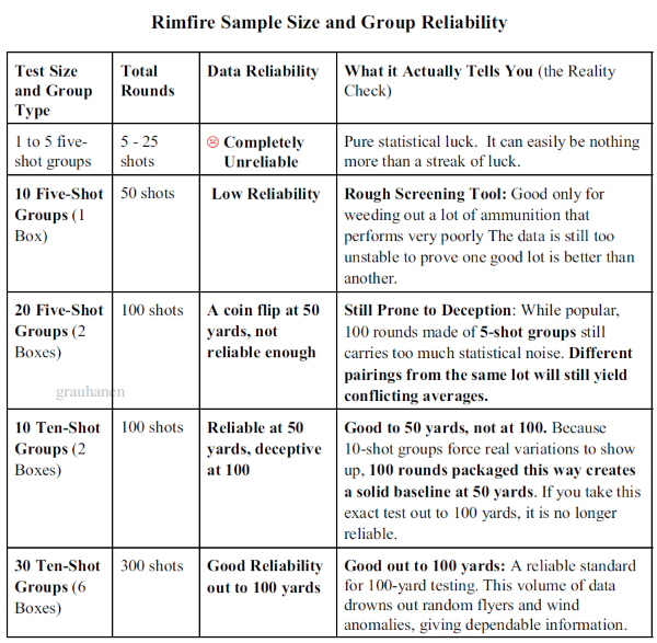

When you go out to 100 yards, the number of rounds you need to find the truth changes completely:
  • 10 Ten-Shot Groups (100 rounds / 2 boxes): This may be an internet standard for testing, but at 100 with .22LR it’s a statistical problem, a trap. At this distance 100 rounds is too small a sample size to average out the stacking variables. Different boxes from the exact same lot will give you wildly conflicting data, leading to false conclusions.
It is necessary to increase the total number of shots (and 10-shot groups). At 100 yards with .22LR much more reliable results require 30 ten-shot groups (300 rounds / 6 boxes). This is a much stronger baseline.
  • Increasing the sample size to 300 rounds provides enough data to more reliably overcome random anomalies.
  • It forces the data to account for a full range of manufacturing variations in the ammo, minor rifle set up inconsistencies, and changing range conditions, giving a reliable picture that doesn’t lie.

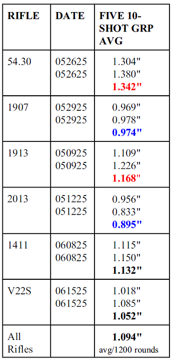

Below is a chart showing results obtained at 100 yards with the same lot of .22LR Lapua Center X. It was shot over a number of sessions with six different rifles. Conditions were calm each but not necessarily equally calm each session. Each ten-shot group average was produced by two boxes of the ammo in question.
The first chart shows results for each rifle with ten 10-shot groups. The averages in blue show results indicating the rifle performed very well, that it “liked” the ammo. Averages in red show poor performance, that those rifles “hated” the ammo.
The 1907 and 2013 rifles “liked” the ammo; the 54.30 and 1913 “hated” the same ammo.

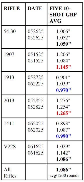

The second chart below shows the same rifles with the same lot of ammo but with different ten 10-shot groups. This time it’s the same lot, different boxes, and perhaps slightly different conditions (even if it’s the same day).
Here the 1907 and 2013 “hate” the same ammo. Now the 1913 and 1411 “like” the same ammo and the 54.30 seems to “like” it much more. It's a flip-flop. Who could have known?
Why the conflicting results?

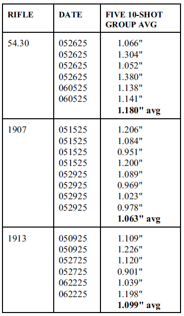

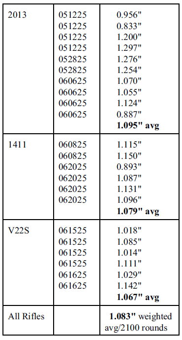

The problem is simply that ten 10-shot groups are too small a sample size to be reliable for .22LR at 100 yards. When the shot count increases to at least 300, the picture becomes more reliable, more stable.
When each rifle shoots at least 300 rounds, the averages “settle” down to more reliable figures. It’s noteworthy, too, that the rifles shot the same ammo similarly.
This pattern can be repeated with other lots of .22LR match ammo tested. You may refer to more details in this thread https://www.rimfirecentral.com/thre...ads/a-comparison-of-multiple-lots-across-multiple-barrels-20000-rounds.1351053/
Ten 10-shot groups are too small a sample for reliability at 100 yards. A sample of 300 rounds in 10-shot groups is much more trustworthy.
What to takeaway from this thread?
Test with ten-shot groups. They are more useful and reliable than five-shot groups. The further the distance, the more shots are needed to get a reliable picture of the ammo.
