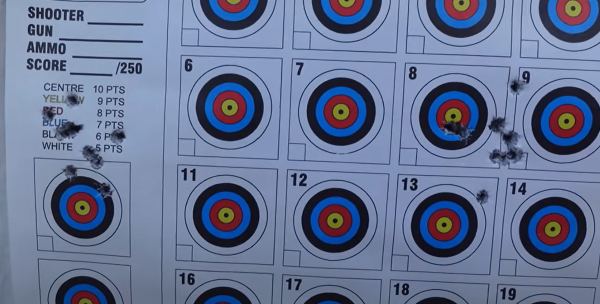

Below is a target showing two groups, the one on the right shot with a rifle that has his "special" non-picky barrel. As he shows viewers the results, he tells them that the group on the right, the one shot with his special barrel, is smaller than the one on the left. Calipers aren't needed for viewers to see that his claim is wrong, but he wanted to show that his barrel shot better than the other even when it didn't.

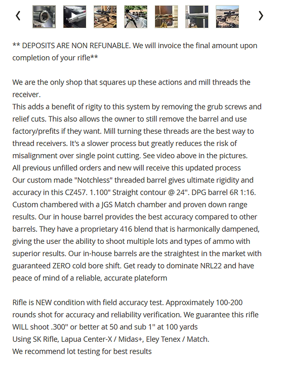

For example, I took interest in his methods of fixing barrels to the action. He had a brief stint with threading actions, which he abandoned in favour of a thermal fit, which is machining the barrel tenon slightly oversize and heating the action while freezing the barrel so that when fitted, the contraction of the action combined with the expansion of the barrel result in a solid lockup. I don't favour either of these methods, as they run the risk of putting stresses into the barrel and distorting the chamber, which has the potential to negatively impact the precision of the build. I'm not going to do a study with statistically significant numbers of examples to demonstrate this, I'm just going to apply critical thinking and do what makes the most sense. In my opinion, the best way to fix a barrel to an action in an absolutely stress free manner is to "glue in" with green Loctite.

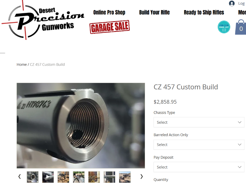

Eagle Eye (Kenny) has a video showing the thermal fit method to attach barrels. His website, however, currently says barrels for the CZ 457 rifles he builds are threaded.
On a related note about barrels, readers may remember that the the video claims that the DPG barrel is special -- it's "harmonically sound" and "harmonically dampened" and has special rifling for better G1 BC. According to Kenny it will "shoot very well with anything you throw at it."
Nevertheless his website recommends lot testing "for best results" -- something that serious shooters understand and other .22LR barrel makers take for granted. No barrel is so special that it will actually make all match ammos shoot well.
See h ttps://www.dpgunworks.com/product-page/cz-457-custom-build
that right group may not be smaller, but wouldn't it be considered a better group

Kenny was trying to show that his DPG barreled rifle shot better than the RimX with the Shilen barrel and "lot tested" ammo.
Whatever the merits or shortcomings of either, what's more important is that no one should make any judgements or make a sales pitch (which is what Kenny is doing) based on a single group. That's just wrong because it's unreliable and misleading.

Interesting. Kenny's video showing the thermal fit is not even a year old. I seem to recall him stating in a video that he used to thread the actions but saw no real benefit to it and now just does the thermal fit. It is unclear why his website is not congruent with his videos. His claims about "harmonic dampening" come across as marketing malarky. What makes more sense logically is that he is using greater than 1 inch diameter barrels, which would be more rigid than their narrower counterparts. This would make the barrel have a lessor tendency to string vertical with a wider selection of ammunition, or, to be "less picky" as another way to put it.
