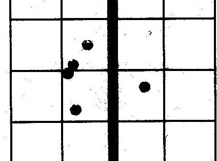

On a calm day, shooting quality ammo from a known accurate rifle,
I have shot many 5-shot groups that are less than 1" at 200 meters.
22 rimfires are often underestimated, but those of us who use them
a lot know what they can do.
Targets below were all shot at 200. Grid is ½" squares.
Eagleye
Again we run into doubters. I have nothing toprove but indeed these wee rifles are so underrated. Not only on paper but on live targets. Long distances can be achieved but i only judge myself on a inch and half sized head of a gopher. Close enough for me with Winchester 333/555 ammo only.
What can be done with match ammo i have not tried. Know your gun and scope and your own capabilities and the accuracy will show.

While I have shot enough targets like this to believe that it is repeatable, the
22LR is so sensitive to even a zephyr of a breeze, that it is quite
challenging to shoot these very small groups, time and again.
One very quiet morning, I shot 3 out of 5 groups that were 1 moa or less
at 200. Another time, I managed only one out of 5. Some times, there are none.
Keep in mind these were shot with a 40X Remington and a Suhl 150, using
Eley Match EPS Ammo of a specific lot that the rifles shoot best with.
When someone posts stellar results, using bulk ammo, I always regard it
with some scepticism, since I have shot many brands of bulk ammo, and
the flyers will get you, time and again.
Regards, Eagleye.

Hey Eagleye~no offense intended. That's nicer gear than I've ever had my hands on, but even if I did...I'm reasonably sure I wouldn't be able to duplicate that. I hear/read all kinds of things that I scratch my head about, and only have my own (albeit, less time than you) experience to call upon. I've seen minimal-to-non-existent breezes blow a .22lr round off-course @ 110 yards...and THAT I've experienced 100s of times. If I shoot sub MOA with my .223 @ 200 yards (Savage Precision 10 Carbine) I pat myself on the back for the rest of the day. And that's the truth! :)
I guess some more practice is in order for me.
No offense taken !! Life has taught me to "thicken" the skin, lol.
Gear does make a difference, no question.
I just won the local IR 50/50 shoot here a couple of weeks ago.
Didn't have to break out the Suhl, just shot the 40X Remmy.
I really appreciate your comment on the wind.
If you do not have flags up all along your course of fire, you may
have no idea what happened to that "stray" shot that is 1½" or more out of the group.
I was at a BR 22 rimfire match a number of years ago.
The wind was playing crazy tricks, so I was shooting more sighters than usual.
Paid off though...I shot a .615" - 10 shot group at 100.
The shooter to the left of me had 9 in slightly less, but got caught by the wind on one,
making his group slightly over 1"
My equipment at the time? A 541T Remington with a 6.5-20 Leupold, shooting
Lapua Master L ammo.
Regards, Eagleye.
