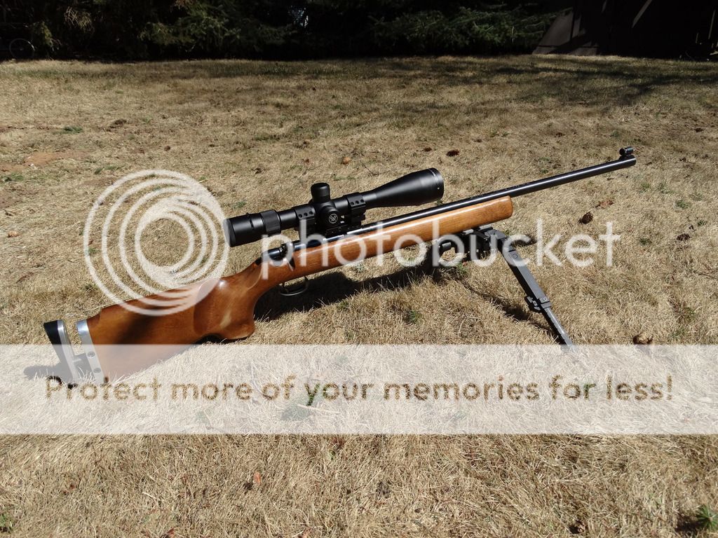

Just a little update.
I cleaned the barrel and that turned out to be a bad idea. My groups opened up quite a bit. I've fired about 200 rounds since and it settled back down.
I bought 4 bricks of different ammo. One SK standard plus, one SK rifle match, one Eley Club and one Eley Edge. Hopefully one will work well. So far with my limited testing Eley Club seems pretty good.

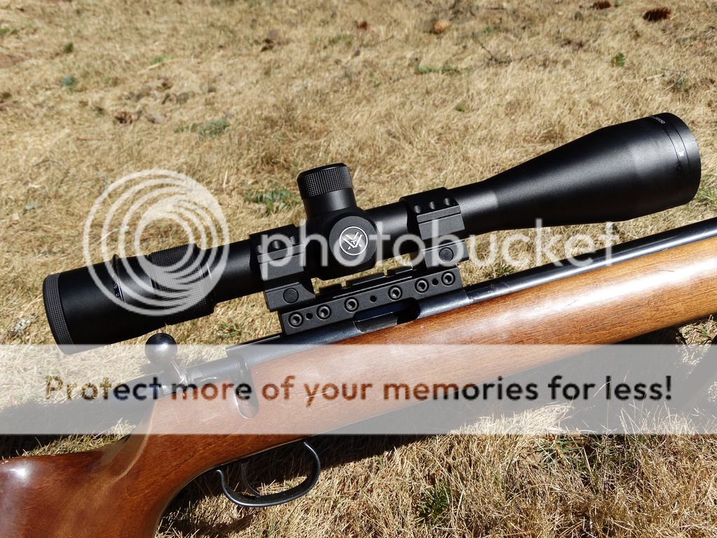

I decided to try out a BKL dovetail to weaver adapter. It seems really well made and clamps down pretty tight. The only down side is the height it adds. I'll have to figure out some way to raise the comb to get a proper cheek weld. I did have to mill the bottom of the rail to open up the loading / ejection port. I think I'll have to open it up more then what I did on my first try.
I also swapped out the scope for a Vortex Viper 6.5-20x50. It has a parallax adjustment so I should be able to eliminate the tiny bit of parallax error I had with the Bushnell 10x40.
I'm still questioning the factory bedding. I torqued my action screws to 40 in/lb and I can very easily move the barrel around in the barrel channel.
It turns out that shooting rimfire well takes a good amount of work. Hopefully this project pans out.
