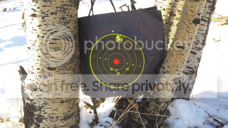

I pour 44.0 grains of IMR 4064 into a 2.035" Hornady case with a Winchester WLR primer, seat to a COAL of 2.650-2.655"...
They cruise along at about 3800 fps, and group about 3/4" @ 100m with my shaky hands.
The target shows 1 sight-in round (just off the top of target, on the paper) and 2 groups of different projectiles
One 5-shot of 58gr, one 4-shot of 90gr (bottom-center). 58gr Vmax is the top (3/4") 5-shot grouping.
Rifle is a bone-stock Savage 14 American Classic.
