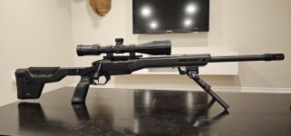

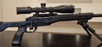

Sounds like a nice build. I'll post pictures of mine in a few minutes
Here she is:
Action: Kauger VPR
Barrel: 20" IBI Carbon Hunter 1:10 243 Win
Chassis: MDT HNT26
Trigger: Triggertech Special
Scope: Zeiss V4 6-24×50

Seemed to be the standard for any 20" 243 factory rifle. Figured it was my best bet
It was standard for a long time, but other brands went with faster twist rates. Savage uses 1:9.25, Remington used 1:9.125 for a while and just switched to 1:8, Tikka just switched to 1:8, some have used 1:9, it's all a part of the pivot to long and heavy-for-calibre bullets.
The SAAMI drawing specifies a 1:10 twist so factory ammunition conforming to the SAAMI specification needs to stabilize in that twist rate. I would usually just try to find the most accurate factory load use that as the basis for my handloads.
My 20" .243 really likes the 80gr Federal blue box and seems to shoot the 80-90gr stuff better than the 100gr bullets, but each gun is different in that respect.
If there is a good-performing factory load with a commercially available bullet I would aim to duplicate that. With good components behind the same bullet loaded to similar overall length you should get pretty close, then tune from there.
