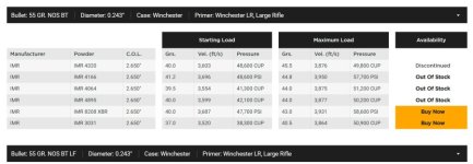

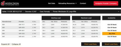

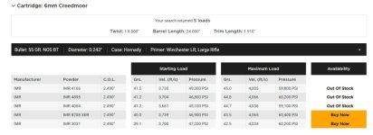

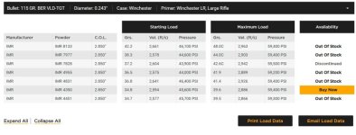

Now enters the other side of the coin:
Oh wait, they did!
And at the same time they shortened the cases so they would run in AR10mags in free countries…
