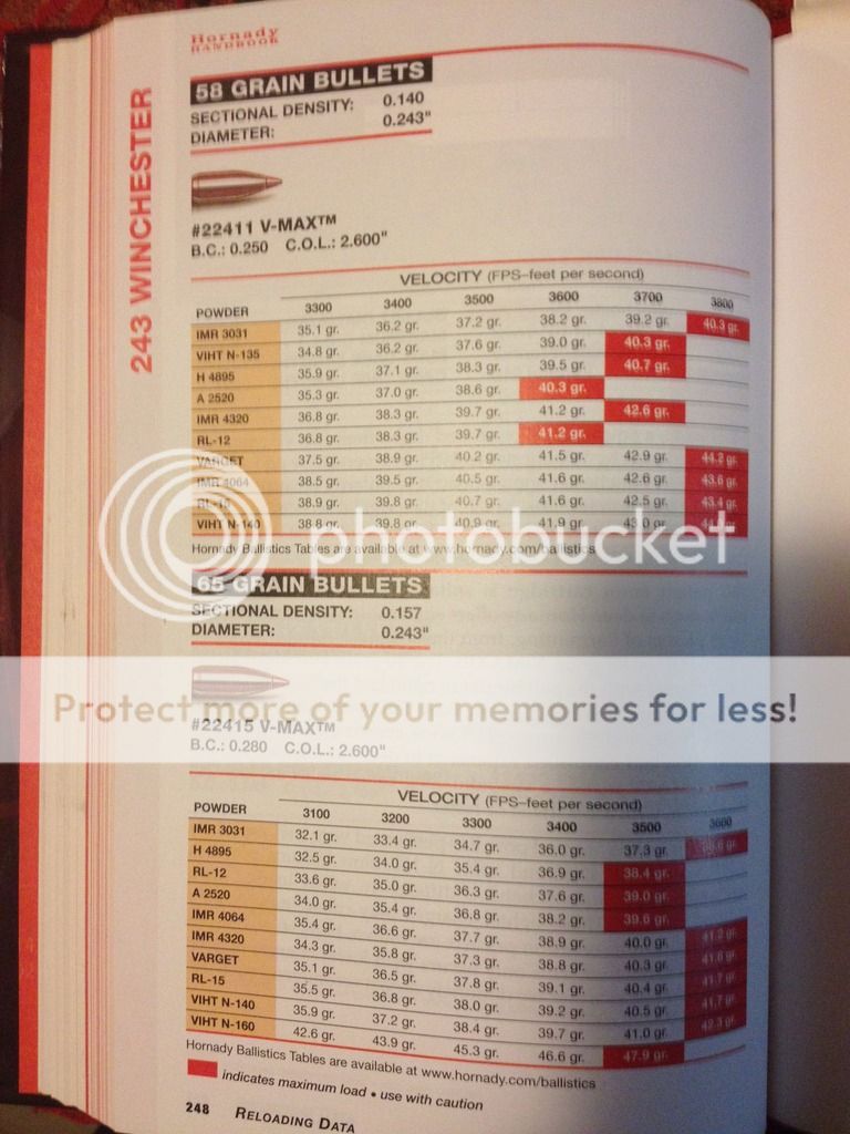

65VMax 43gr Varget in a Savage or Remington if you feel like spending the money on the later. It likely won't shoot any better. You don't need the heavier bullets. They are all hard on hides and FMJ's are hard on your sleep due to the ones you wound if you have a concience;) The 65's will be across the field and the coyote will be dead before the others are out of the barrel. Anyone who thinks the fast twist barrels of the .243 won't stabilize light varmint bullets aint shot many .243's. Funny so many light bullets have been developed by those bullet companies for those barrels. Dang somebody with some dire expertise ought to have warned them it was gonna be a market failure eh!:rolleyes::rolleyes:.
You mentioned coyotes were the target of choice. The heavier bullets are ment more for the deer antelope size stuff. They have higher BC but that will only start to work for you out past where you should be shooting at coyotes anway. Only Captian Deadly is capable of shooting 'em past the 400 yrd mark with any consistancy.

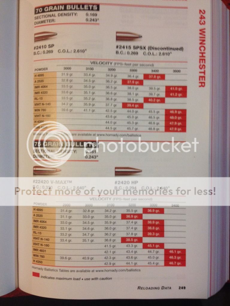

Ohhh, supercub and big bill are off for a 6mm Circle-jerk!!! The 243 is the first centerfire i owned, and it has acounted for many deer, out to 280ish yards. I know how to shoot it so dont ##### about that being unethical. I foung that hornady's 75 gr HP is alot nicer to the hides than the 70 gr ballistic tip. I think coyote season is coming on isnt it. I wont ##### about the 6mm though, especially because you need a bastard-length action to run it properly
