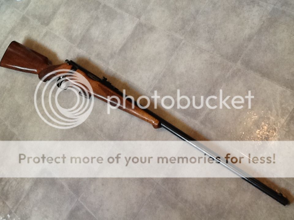

Why go through all of that trouble when you can just get one of the Husky's that was made in 25-20 ? Model 26
Those are nice looking guns too. Tradeex sells these rifles, IIRC, from reading a recent post. Are they fairly common in 25-20? That may be a good option for you.
I have one, but I don't think that you see them as often as you do the 32-20.
