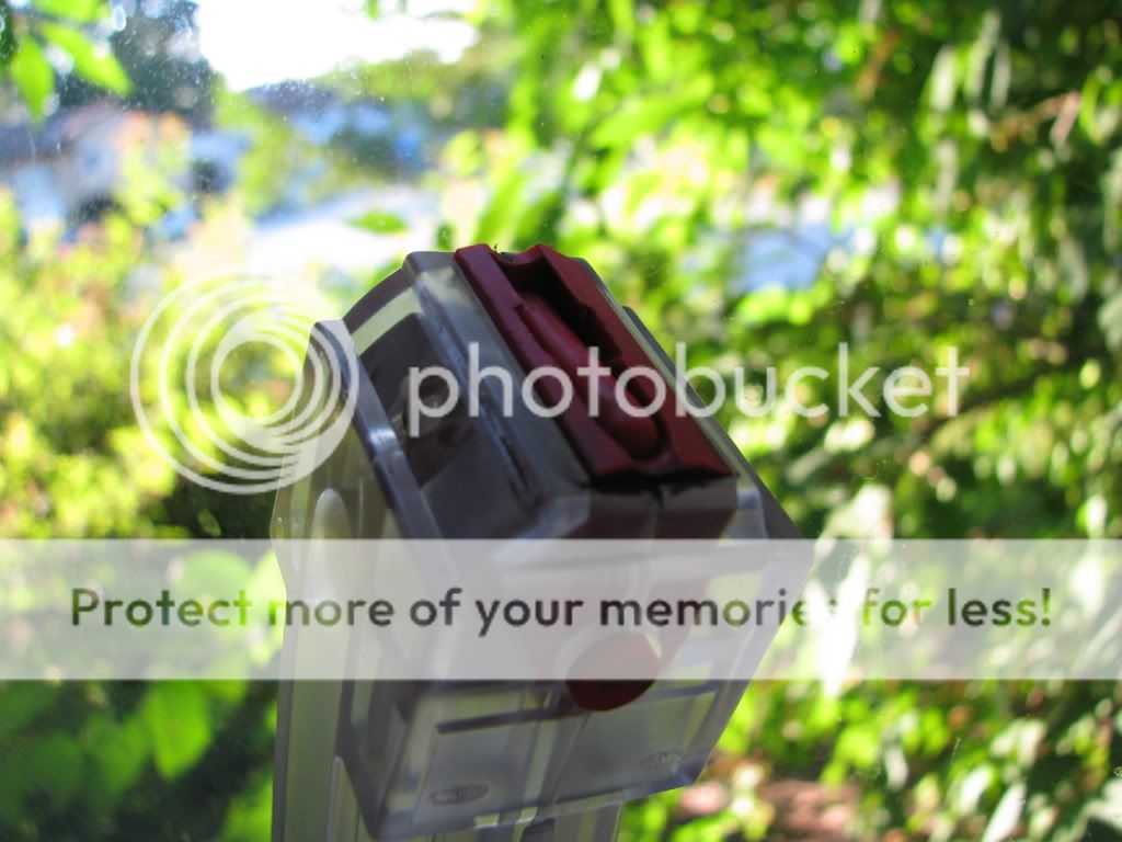

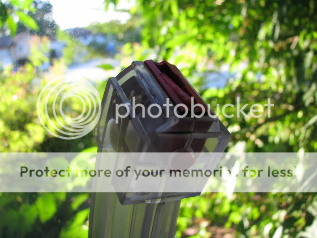

It's this one. Is it a good one? Does everything look right on it? I couldn't even get the action to load and close on the first round. I DID, however, fill it to 25 both times.

Ibought 4 of the same mags 1 had the same issuse you had.. I just loaded and undloaded it a few times and it seems to work with 0 issuses after dumping a few rounds through it try putting in 20 rounds and shooting that for a while should fix some of the problems and if you still have issuse put pressure on the mag so it forces it up top of the gun.. that was another trick that after a while I didnt have to do anymore because it was fireing fine after that..
Well I can't even get one loaded in the gun without it jamming. But I'll give it a shot.

I haven't taken it out again. I've loaded it a few times with different amounts to try and break it in and then got bored of that. But while doing that I noted that I can't take my nail and push out the top round from the rear of the cartridge until the last 3-2 or so. I was trying to ownload the mag quicker by just pushing them out but there is too much tension (i guess?) for them to slide out of the mag until the last couple. Is the problem that the spring is just reallly tight until it's broken in?
