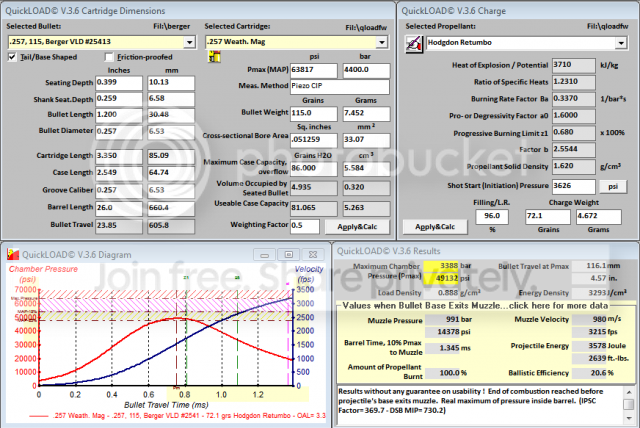

here's the "Quickload" results from my Berger/Retumbo load.
velocity is actually 3315 fps (not 3215 fps)
Results are good (1.25" @ 200meters)
Pressure is actually low (around 49,000 psi
with Quickload, once you enter all the data, the pressure is calculated by the program.
I don't own the program, the results were calculated and provided to me by a guy on a Weatherby Owner's website
