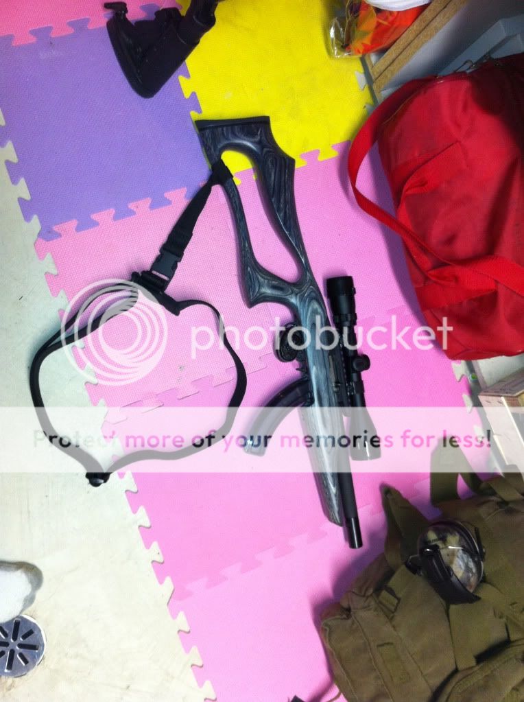

this is 26.5" (without the flash hider) with a 12.5 inch barrel
Probably not the style you had in mind, but a pistol grip:
9" bbl, measures a little over 26.5" without the levang.

FYN what is that stock? It is pretty nice actually.
It's a boyds evo. I originally wanted to go with something a little more "tactical", but for a little shy of $100, I couldn't be happier.
