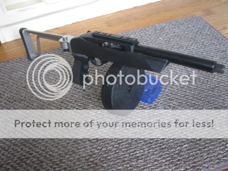

Here you go, we did a minimalist build for a customer, Butler creek stock, pinned open, 8.5 Dlask barrel, drum mag, 26 1/4" OAL....
What do you have to do to have a collapsible stock legally considered to be "pinned"? Is there any way to do it easily on a Butler Creek folding stock and have it reversible?
