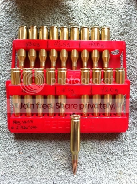

I'm in the process of learning to load berger VLD bullets in my 1:8" twist savage bolt gun.I have a E-mail into Berger for help on data.I have kind of cross referenced the 142Smk data for Imr-4350 against the 140VLD.Now Im second guessing that after doing some reading online berger seems to max out there load at 40.5 or so.Is this because of the use of 2.800" standard length of this cartridge?I can seat my 140`s out to 2.920" in my gun giving me more room for powder no?

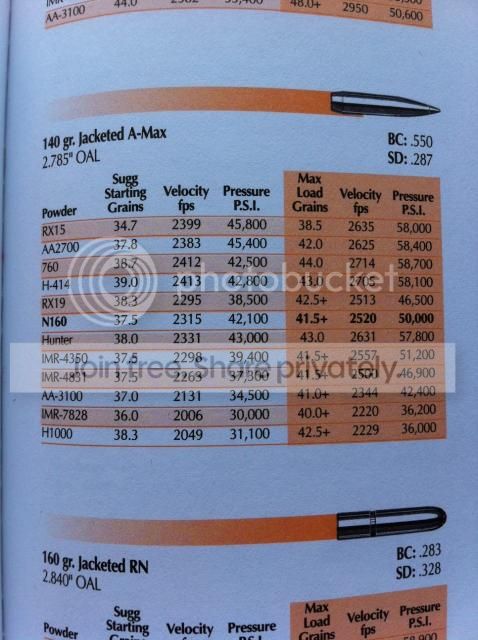

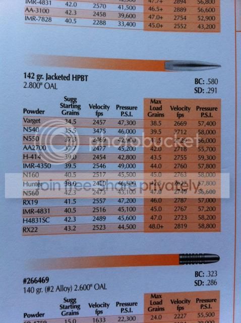

Also the pic below from my lyman manual for the two 140 bullets with imr-4350 is confusing as well with the max grains difference.
so in your opinions what should I me loading the 140 bergers to with the given products in the pictures below.(I also have H-1000)

Different bullets will give you different pressures, that's why you'll see the different manufacturers posting different min and max data. I'm not home right now, but I can email a picture from the Berger book if you want later today.
Thanks Tenguns that would be a great help.my thinking was the SMK would have been the closest to a VLD bearing surface wise?I will PM you my email

I used 4831SC in my 6.5-08 (basically 260 Rem). Never really had any luck with 4350.
If you have access to 4831SC try working from 44-48gr with the 140VLDs
Use a chrony to get into the 2850fps range.
I always cross reference with a number of manuals and online sources. I start low and work up to the max looking for pressure signs or where I hit the speed I want.
47gr of h4831 gets me 2810 with 140 VLD type bullets out of my 26" bartlien barrel. I need a sporter weight 260 to go with my heavy.
