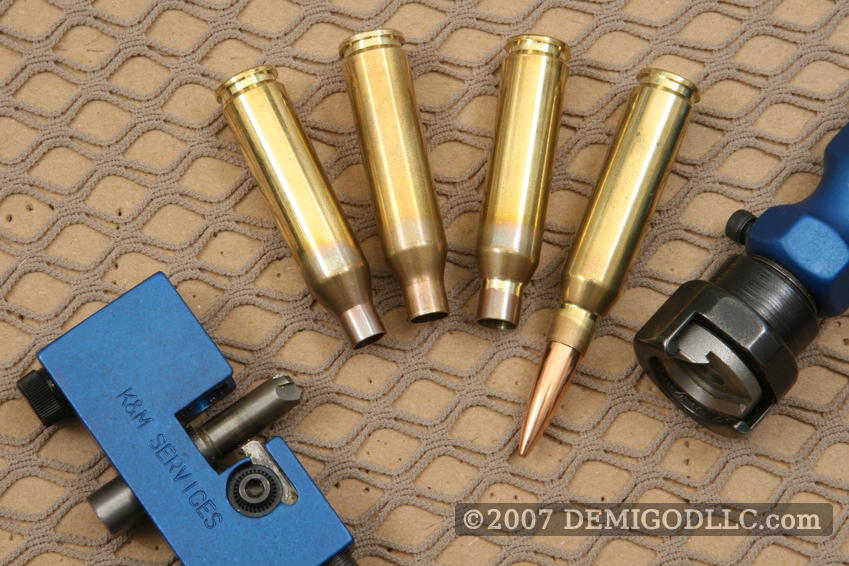

Well, I guess Zak Smith has already answered it then... New Lapua 243 brass necked up to 260:
BINGO. Thanks for posting the pic.
The most common brand that has this problem is 243 Lapua. I am in no way saying the brass is bad - just the opposite, the stuff is built like a tank...
But because the brass is so thick in the neck/shoulder area, any reforming is a chore and there is extra stuff that needs to be turned or reamed off as shown in the pic above.
Biggest bonus for using 308 or 7-08 brass, the new 260 neck/shoulder is still in the orig neck portion of the parent brass so there is no issue of donuts or excessive thick brass to deal with.
See the end of the carbide .260 mandrel on the K&M neck turner. Those flutes are a donut cutter. If you have or get donuts at the base of the neck, this cuts them out from the inside. Problem solved.
NormB
Good thought except that is unfired brass. The brass does not yet have the sharp corners at the neck shoulder junction from being fire formed.

When you expand the neck from 243 to 264 you move the neck shoulder junction and make a new one. This is not as sharp as the factory formed one and brass is pushed to the outside. Obtunded is correct about the new shoulder not being as sharp. You can see from Kombayoch's the photo that outside neck turning cuts some of that thickness off just ahead of the shoulder. It doesn't get it all.
After firing a few times and resizing the necks, the chamber and die push the extra thickness at the base inside the neck. This forms a donut. This is compounded by brass tending to flow forward from the shoulder.

If you look at the pic, life may not be so simple. Again, I recommend neck turning with ANY brand of brass especially when the orig format has been changed. It only takes a few seconds to do and can save so much headache.
As I said in the other post, having the ability to outside neck turn is going to be a great thing as sooner or later, you will need to do it. Brass flows so your necks will not be concentric or even in thickness after a few firings.
Again, get a tubing micrometer and pin guages to test for yourself. Lots and brands vary and will react different depending on your pressures and other sizing steps.
