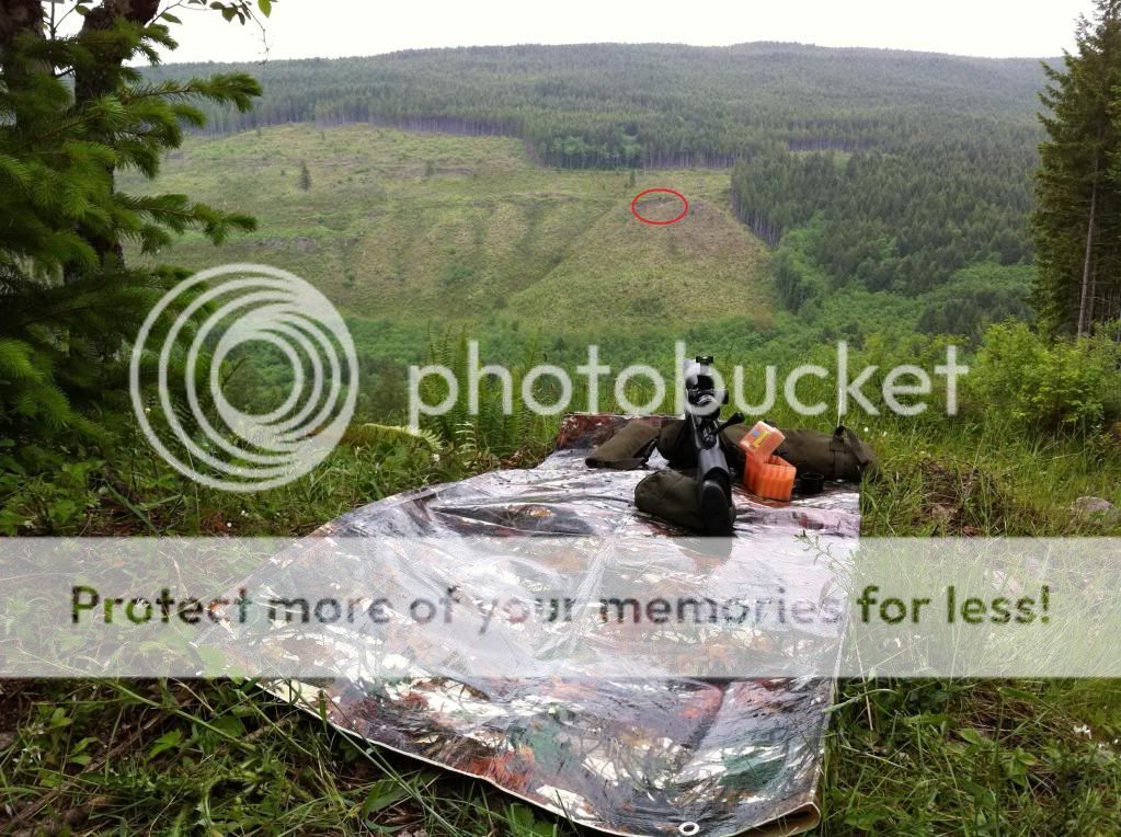

The combo you have there is an awesome long range rig. I love the Berger 140 VLD's and when pointed, they are pretty much on par with the Berger 7mm 180s. Your rig has far less recoil than the 7WSM you would need to match that performance, and has likely as much as twice the barrel life.
How are you finding it for cleaning/fouling, and where are you seating your bullets in relation to the lands?

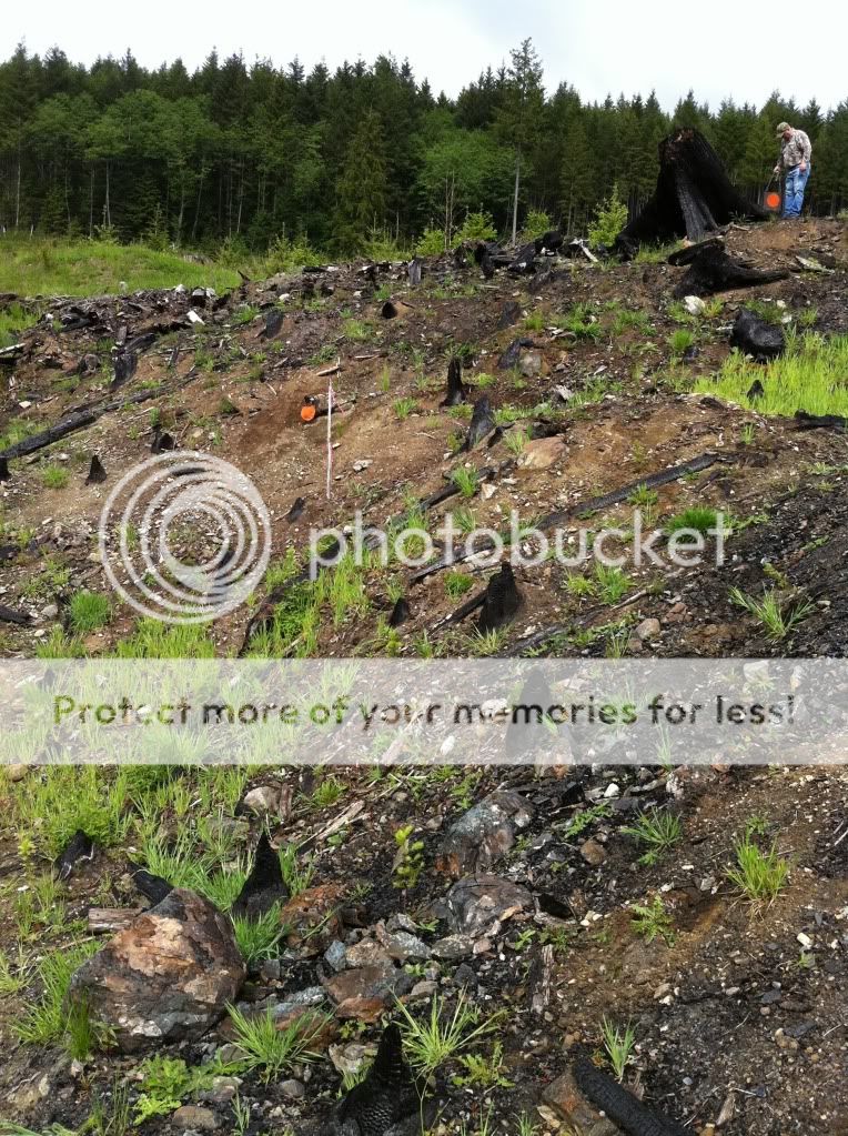

PUT UP SOME RIBBON OR FLAGS
very nice spot and very nice rifle! nice to see you finally got out to a good distance with it!
i know you wont and dont expect you to post directions on this board, but if you feel like it wanna shoot me a PM with the general area of that spot? i havnt had any luck with finding a good, safe area past 5-600 yards..or hell even meet up one day and do some shootin?

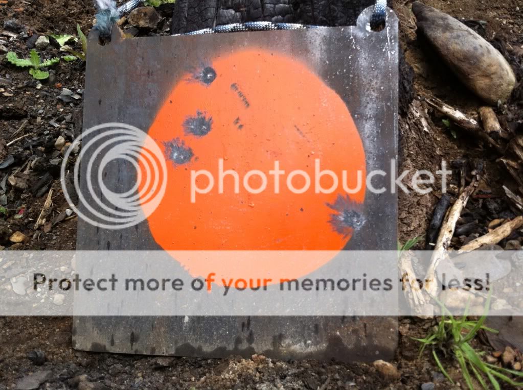

Every barrel is different but I have yet to see a 260Rem shoot the 140gr Bergers over 2900fps through its lifespan well. Keep an eye on pressures and tuning as round count goes over 200rds, then again when you pass 1000rds.
My 260AI/6.5 Mystic all go high 2900 to just over 3000fps when new but quickly drop to 2900 2950fps after a couple of hundred rds (this in 7 barrels from several manf).
Recently, I have just started tuning for 2900fps and save myself the hassle of a second go round.
For the 260Rem, a number of shooters have found their most stable node around 2800fps. And this node is SUPERBLY ACCURATE. We can always dial for drop. When a load is consistent, even windage is easily accounted for because it goes where you expect.
Clear sign that you have gone too far is vertical flyers. Can also happen later in the day when ambient temps rise (I lived in Victoria for years so know, it can get warm a few days a year).
Consider flagging along the ridge up to 50yds away from your target. Winds do all sorts of nice swirly stuff and can change directions in a hurry. Nice to get some warning by having flags further away from your target.
Also, flag below your target - you'll be surprised at what you see.

Also, it needs to line up with you bullet flight path. A wind flag sitting 50' above or below your bullet tells you nothing.

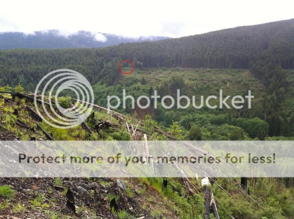

He is shooting over a valley into a hillside near the crest of several hills.
I bet he has seen some interesting winds
