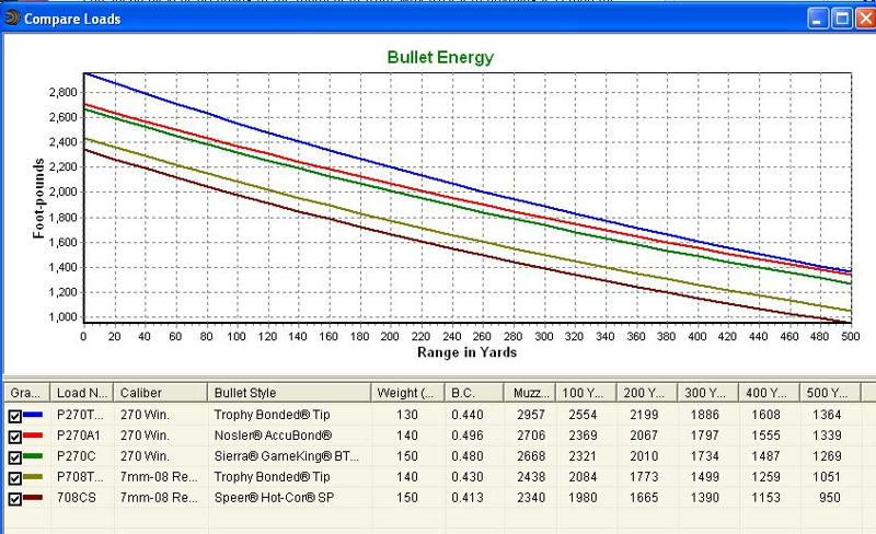

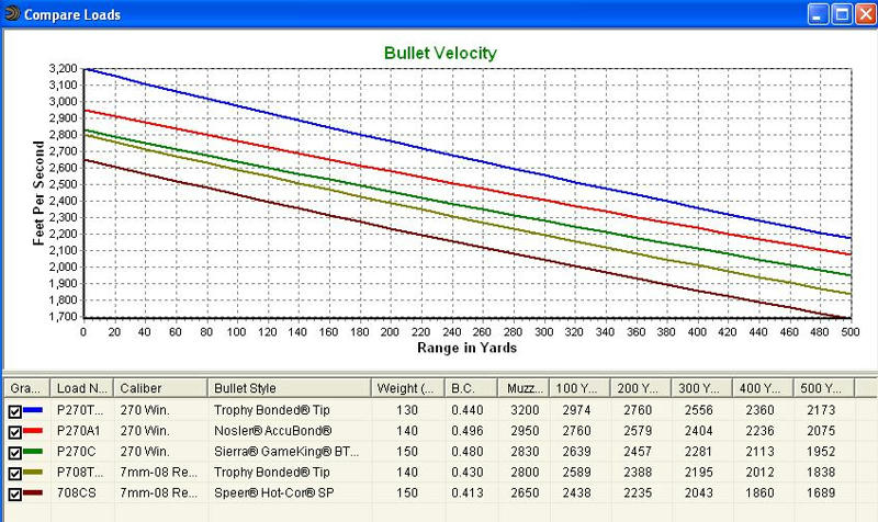

Still, the top 3 in each bullet weight goes to the 270. Could a pattern be emerging?

I was just going by what the Remington site said under ballistics...I compared awhile back a 140gr .270 and a .140gr 7mm-08...according to the Remington site the 7mm-08 was faster and had more energy at 400 and 500 yards...check for yourself
