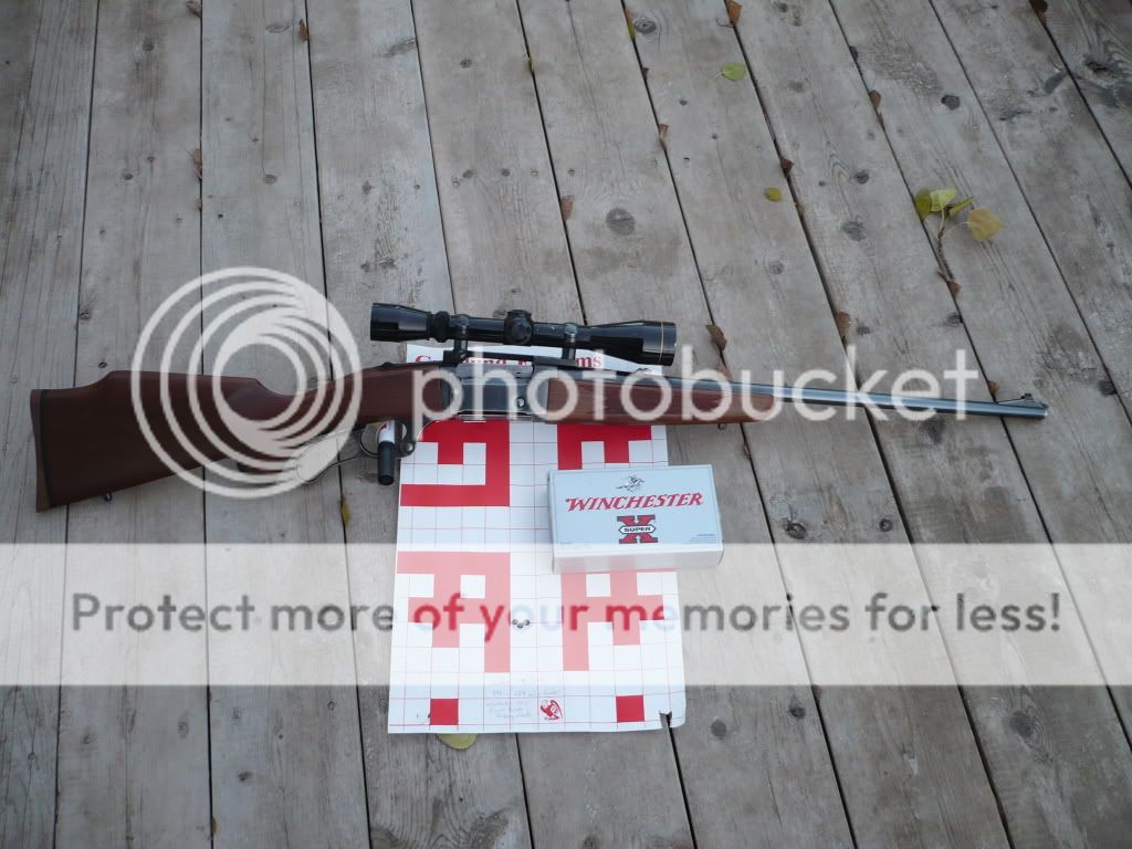

Rem338Win has a beautiful 284 Win, but short action M70's are hard to find and the list of guys who can build a 284 on one that runs right are short. And the guy who built this one? Chances are good he's not interested in doing it again... ;)

That was kind of my point about action length, I had a 25-284 built on a Remington 700 and the mag length limited it to 2.84 inches.

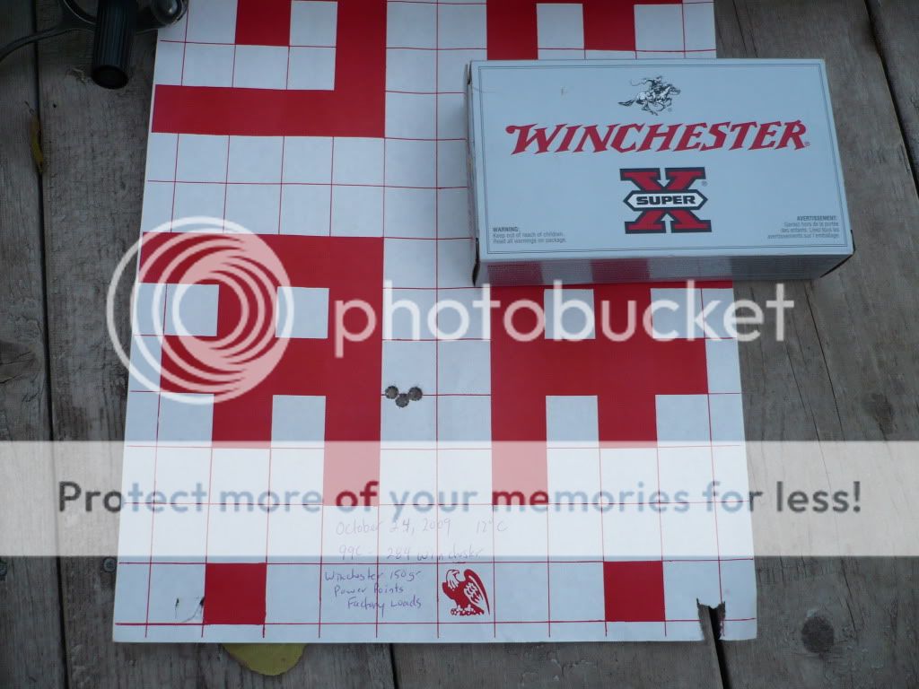

x2 to what Rick said. I love the 284 (being yet another owner of that one pictured) but it takes the right builder to build one that feeds right. Everything has to be perfect (and that one is).

I'm pretty happy with my 284. It is my go to hunting rifle at this time.
:agree: Pretty impressive grouping from an equally classic firearm in a classic caliber. I'd hang on to that....I know a guy that might just jump on that beauty. :)
