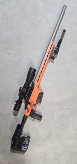

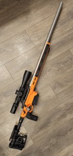

280AI Long Range Build.
Great looking rifle. That speed sounds about right... never really found super long barrels to give me that 'extra' speed expected. Maybe your barrel will speed up??? for me, the fastest accurate speeds were always in the first 100rds+ then the barrel slowed down as internal pressures increased.
Enjoy...
Jerry
PS, keep an eye on the bolt lugs and uneven wear. That is a whole lot of barrel hanging off the front unsupported (assume you didn't bed the action). Actions can bend under load.
every barrel I've gotten from KS tends to speed up about 100-150fps
Hopefully my N565 Arrives this weekend and i can brave the cold for a range test to see what happens!
Does a 1,25"cyl x 35" barrel really benefit by free-floating in a chassis?
compared to a pressure point over a bipod? curious here
No way to know, I think, til ya shoot it. I'm betting it will be fine. Pressure points are tough to tune, and only used as a last resort, in my experience.

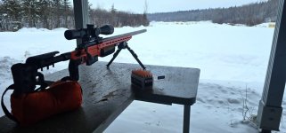

Hit 2840 Fps with 59gr of N570. -5c. Brand new barrel. Previous barrels I've experienced a 100fps + Gain once shot in a bit. So we will see how that goes. N570 isnt the ideal choice byt it was what I had on hand, waiting for some N565 to be delivered.
As expected. Very little recoil. Took it out all the way to 800m

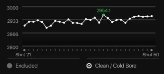

Cant say the cold was doing me any favors for group size! But we hit 2950 fps!
ES isnt great.
My thoery as to why
-Warn out mainspring (action wa second hand)
-needing a magnum primer
-bench mistakes with the thrower & drop tube combo. Some kernels got hung up.
Well see what the warmer weather brings!
