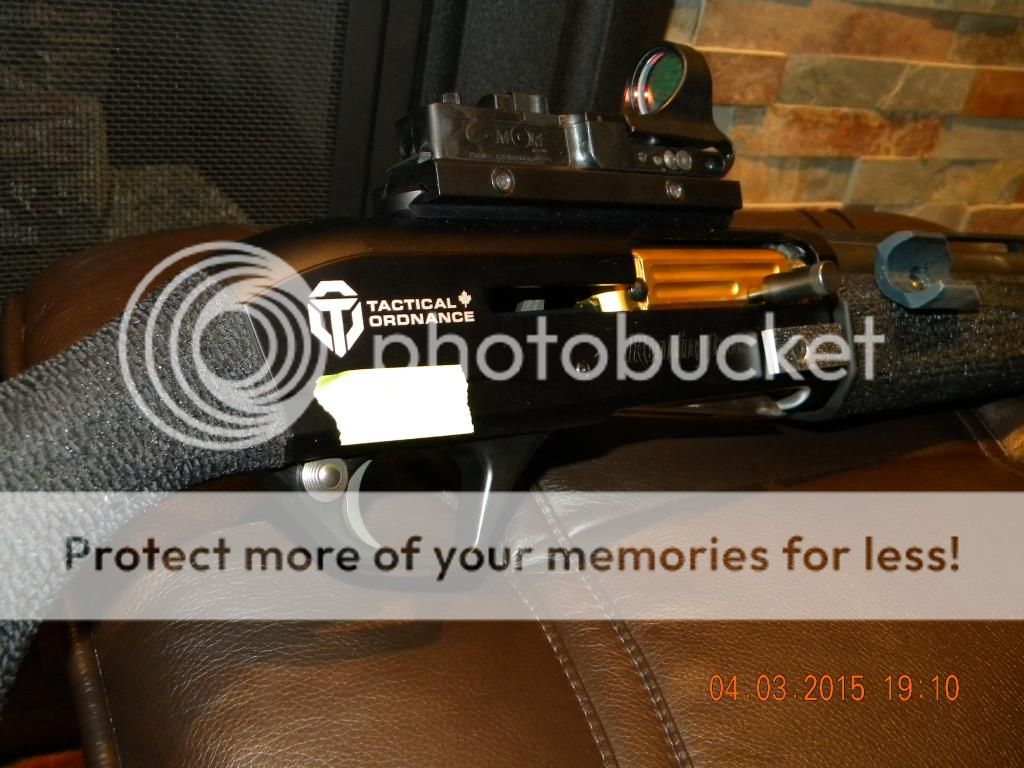

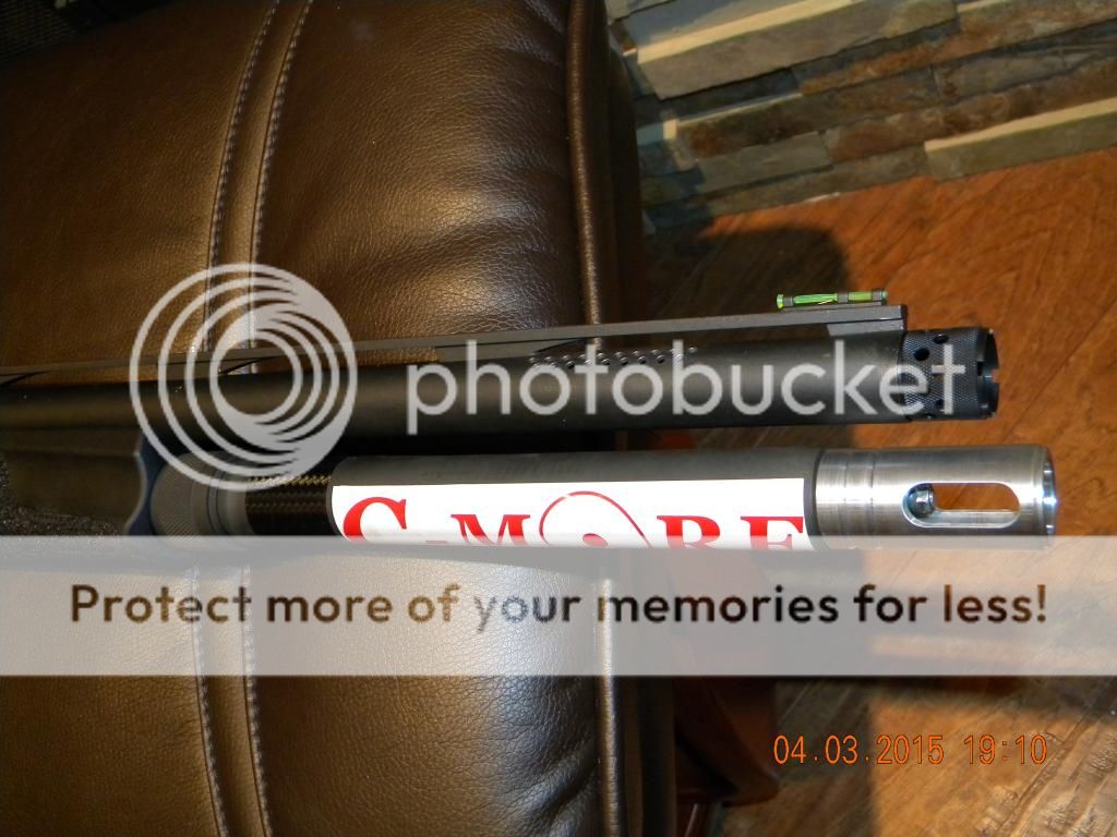

Don't mean to hijack the thread, but here is mine that I just got back from THE MAN (Casey) for some updating. When I bought it from him, it was the gun that he had built as a demo for the IPSC Provs. I think it was his first VM. It ran like a top after a good oiling and a couple of boxes of 3" to get all the parts to break in. All the work was done by Casey except for the stippling, comb riser, C-More mount, oversize bolt release, match saver and barrel dump extension which I did myself. I decided to convert it to Open Major as I shoot Open Major pistol now and really like the red dot deal. I'm not out chasing a championship, I just do this to have fun. Here are some pics.
