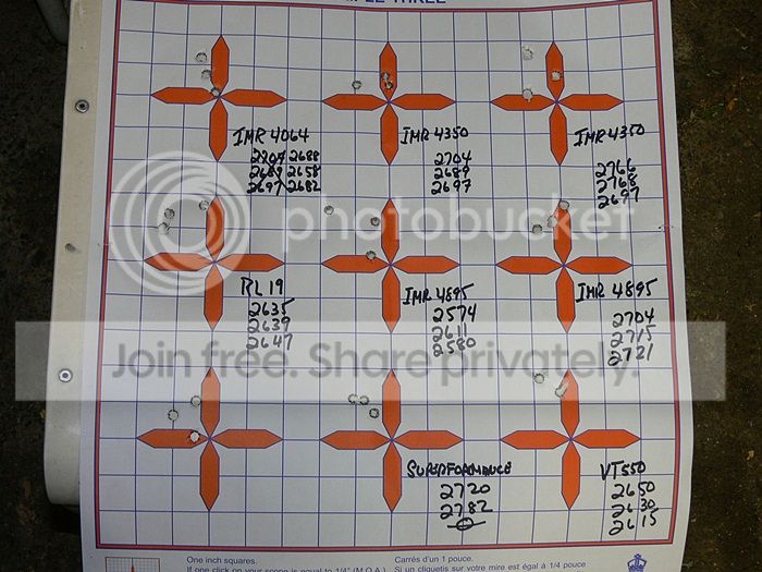

So Ive been working up loads for the 30-06. Its a Remington 700 SPS. I found a very good load using Varget but when i put them over the chrony they are no where close to the publish velocity. In have been tried 1 other powder i have on hand to try and get more velocity outta them.
With the Varget I was only getting 2750 fps with 165gr Sierra GK. I tried 4007 SSC and got close to 2900 but couldnt get anythiing under a 2" group.
I was thinking of Trying IMR 4831 since i have in here... anyone have any luck with that?
Thanks!
Josh
