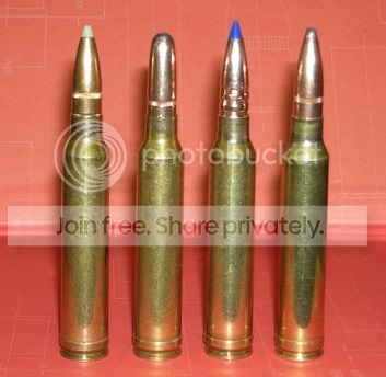

My guess - their test rifle must have had either a short magazine or short throat or both. My 300 WM Sako 85 Grey Wolf has a long magazine and throat so I can exceed the standard OAL and seat bullets as shown -
