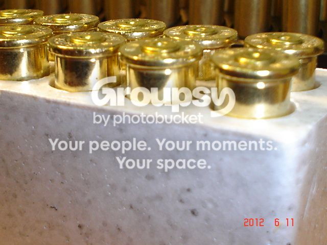

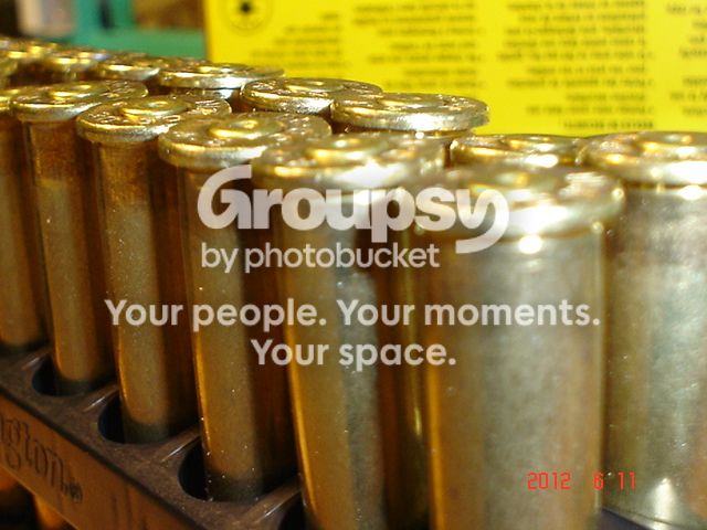

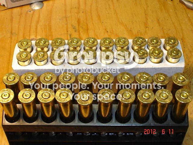

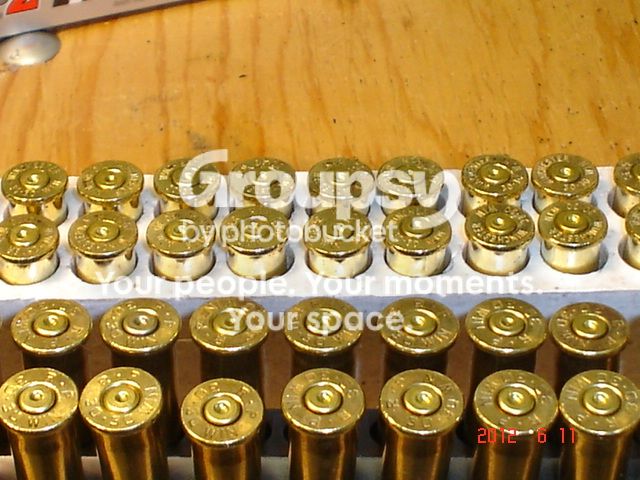

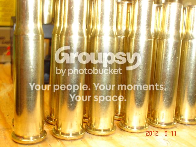

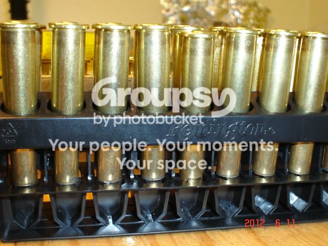

Pictures...I got. I took them today.
Went out to the range and shot some Fusion 150's. Nothing really noticeable in the primers. Could it be the brass itself? A deformation at the moment of impact by the firing pin?...I dunno..seems pretty weird. I contacted Henry and a Technician will be getting back to me tomorrow. Took these pictures for Cabelas, they too will be contacting me tomorrow. As to why the Fusions did not pop (protrude).
Notice in the pics some moved...and others did not. Like I said...never owned a 30-30, so I am quite a noob when it comes to these rimmed cases.
From your photos I would say that you have excessive and potentially dangerous headspace.
It seems odd that you would see that in a new firearm.:confused:

On a side note, if various brands of ammo give different results it could just mean that the rim thickness is different on them.
In any case, those primers are backed out way too far in my opinion and I would definitely have the rifle replaced under warranty.
I doesn't look like it would be safe to shoot for very long.
